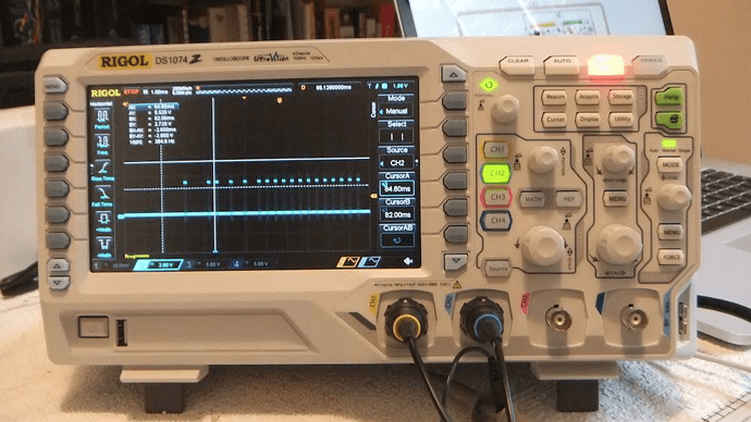

I plumped for the DZ four channel one with signal ggenerator, and I have been very pleased with it so far. The I2C and RS232 anailisis functions are very useful and the deep memory is great. I managed to find a softwae fault by spotting a missing pulse in the middle of a whole mess of signals two months ago.
It takes some learning to drive and I wish the signal generator would drive 5V TTL outputs but over all I have been quite pleased.
Grumpy, what did you buy?
It was the DS1074Z. I have also been programming it in python. When I get a bit of free time I want to do a sweep frequency filter plotting program.
