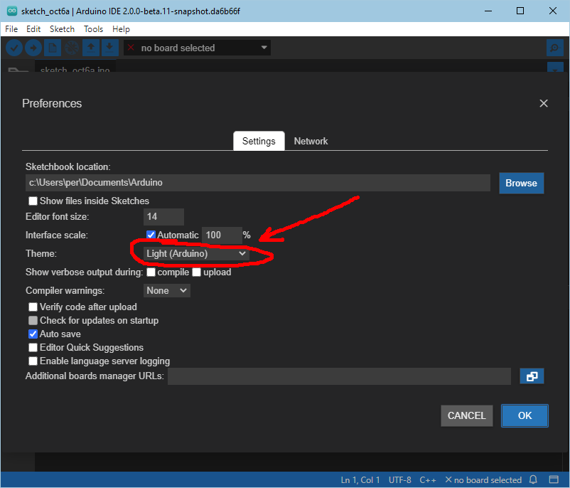

Dark mode is enabled by default, but switches to light when clicking "OK" after changing settings. Will do a reinstall later to test if it didn't happen by accident.

Thanks for your valuable feedback @obel_ix !
The tutorial was written prior to the current "editor quick suggestions" preference implementation, and never updated. I have notified the tutorial author about the problem.
This bug is being tracked by the Arduino IDE developers here:
opened 08:48AM - 07 Oct 21 UTC
closed 07:03AM - 18 Jul 22 UTC
priority: high
conclusion: resolved
topic: code
type: imperfection
topic: theme
criticality: high
When the Arduino IDE is started from a clean system (no configuration files from… a previous IDE run), it is using the dark theme even though the default preference setting is for the light theme.
### Steps to reproduce
1. Delete the IDE's configuration folders (e.g., `C:\Users\per\.arduinoIDE`, `C:\Users\per\AppData\Roaming\arduino-ide`,
1. Start the IDE. Note that it is in dark mode
1. Open **File > Preferences**. Note that the theme is set to "Light (Arduino)".
### Expected behavior
The IDE uses the "Light (Arduino)" theme by default.
### Environment
Version: 2.0.0-beta.11-snapshot.da6b66f
Date: 2021-10-06T08:06:21.909Z
CLI Version: 0.19.1 alpha [718bbbf2]
OS: Windows 10
### Additional information
This does not occur when the same steps are followed with 2.0.0-beta.11
