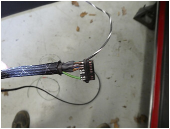

Connectors
The weakest link I have observed so far is the connectors I chose to do the original job. These turned out to be not adequate and failed immediately on connection. I actually found selecting connectors to be one of the most difficult jobs for the uninitiated like myself. Because I wanted this to look like a factory like installation, I wanted connectors instead of screw terminals.
The first set of connectors I chose was the TE 5-102617-6 and TE 102448-6 pair. Several issues I had with this connector set
- Connectors are not keyed. I could easily mate them upside down
- Connectors do not latch together
- Connectors are made for 20ga max wire. I was using 6 20ga and 1 18ga
- The area where the wires crimp on the TE 102448-6 connector is not supported. This became the Achilles heal and the reason I had to replace it immediately. Trying to manipulate this connector in place under the dash of the car, caused these pins to fold and break right at the point where the pin is not supported. I had come to the conclusion that these connectors were made for very light ribbon cables in computers etc. They worked on the bench But?
Below is the TE 102448-6 shown installed on the Automotive wire harness.
TE 102448-6 Installed
After the failure I was able to find another set of connectors that would address problems 1, 2 and 4. Problem #3 was dealt with as it was for the first set of connectors by removing a few strands of the 18ga wire so it could be crimped on to a 20ga pin. It all works reasonably well and is currently installed in the car now, however I am aware of its flimsiness and the latches are weak and it has been known to come loose.
