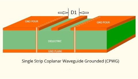

What is the clearance between the copper pour and your traces set to ?
Honestly, I don't know what that means or where to set it.
Distance D1
I believe these are the settings you refer to. Looks like the spacing is 50 and not select-able. I currently have isolate at 0 and it can be set from 0 to 254. The polygon pour is set to solid, the other options are hatched and cutout.
