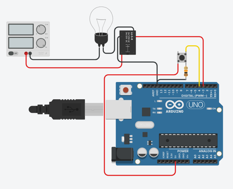

What is connected to pins 3 and 4? Post a wiring diagram.
JCA79B:
Hi! I was thinking something like this, where the button simulates the blinker signal(pin 4), and the other wire(pin 3) is connected to a relay! :slight_smile:
Where does the blink signal come from if it is not simulated with a button?
JCA79B:
I was thinking that signal would be taken from the wire that goes between the cars blink relay and the lamp itself, but perhaps thats a bad idea now that I think about it(too high voltage etc?) :o
Ok, so I'll change my approach. A constant signal(the same one that goes into the cars original blink relay is going to be fed into the arduino. Might make some things easier to me! :slight_smile:
So, you want the side marker lamps to blink in unison with the turn signal lamps and to be on steady when the turn signals are not blinking. Is that correct?
JCA79B:
Correct! I want the side turn signal lamp to blink in union with the rest of the indicator lights, and then be turned on(steady) when not using the turn signal. Just as you said :slight_smile:

You could do that with only a 12V relay if the side marker lamps blinked in anti phase (marker ON when turn signal is OFF) is OK.
The marker lamps powered through the relay normally closed contacts and the relay coil powered from the turn signal blinker.
JCA79B:
Thats how people usually do it, they short the turn indicator light with the signal from the front position light, which means when they use the turn indicator, the side indicator is on when the other turn indicators are off. The issue is that having it that way is illegal. The only way the side turn indicator is legal as a side marker is to have it blink in sync with the other ones. :confused:
