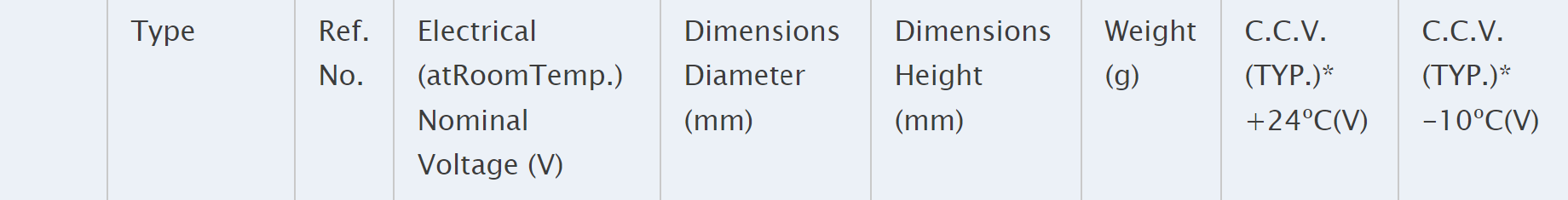

mA is the is milliamps which is the current draw. Even if you were right and the module only pulled 30 mA, that is still over 200x as high as the normal draw on these batteries, 140 uA (microamps). They are not going to power your device. Those batteries are not high current output batteries. They are designed to give low amounts of power over a long time. You need a battery with a high output current.

What if I used SR936W? They are same as SR936SW but high drain?
