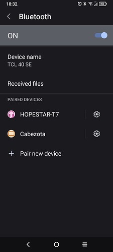

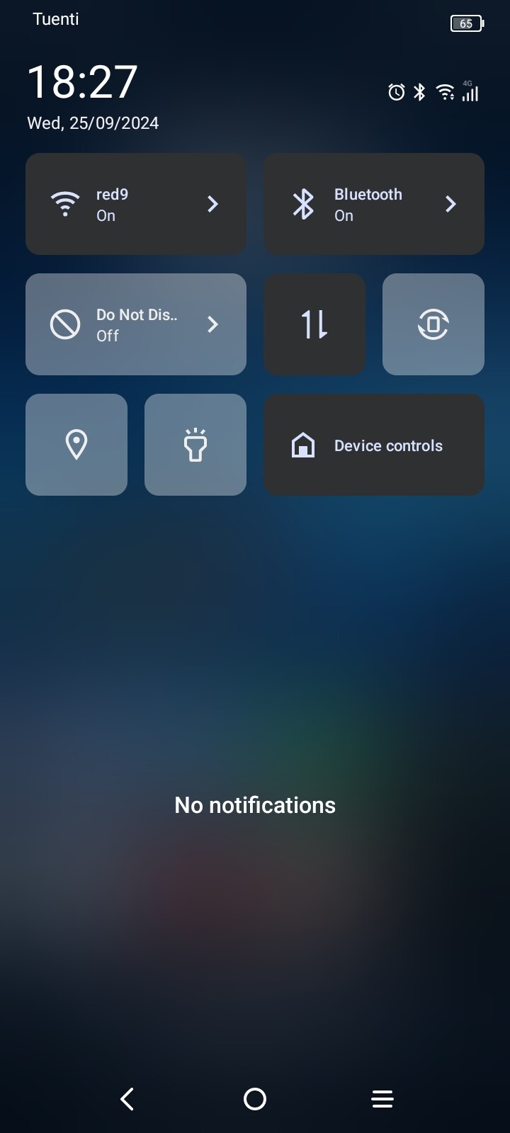

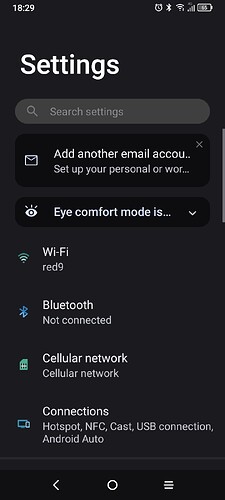

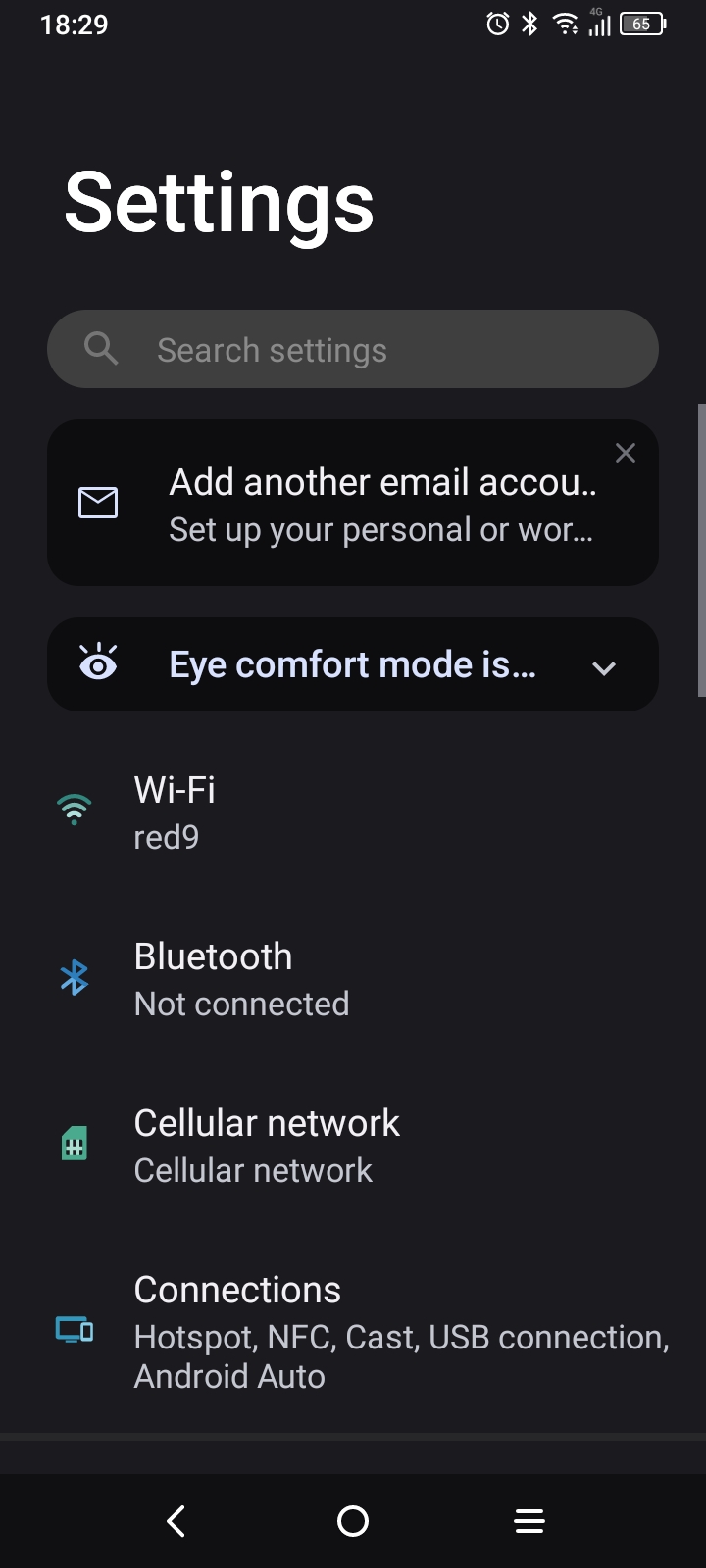

Look what i see with my NodeMCU paired:
just "on" but not the name of the device.

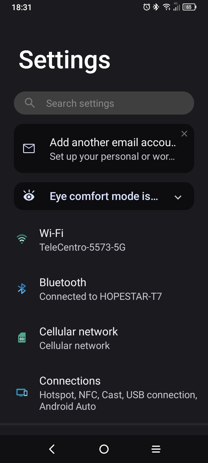

Look my bluetooth speaker:
Look in settings:
Here say "no bluetooth..." but it is connected, i can see and send from the serial app.

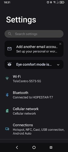

This is with my speaker:
"Cabezota" is the NodeMCU
This is in the bluetooth section when connected to my speaker:
This when connected to the nodemcu:
