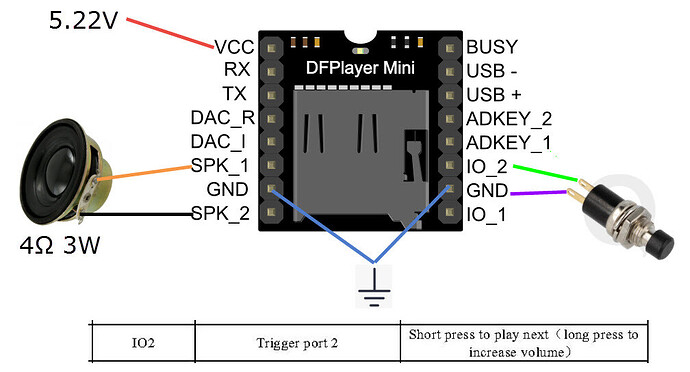

here the DFplayer pinout
77048a25b85b6e29438244020e7237e1
Make sure the RX of the DFPlayer is connected to the TX of your Arduino, and the TX of the DFPlayer is connected to the RX of your Arduino.
yeah the dfplayer rx is connected to pin 16 (with a 1KΩ ish resistor) the tx is directly connected to pin 17 and ground vcc and the speaker wires are definitely correct since it can play songs with bridging the io pins
Unfortunately, the photos are very blurry, all the wires are the same color and it is completely unclear what is connected where.
Is the GND of DFplayer connected to GND of Mega?
Also, the speaker connection looks weird. If I see correct, the speaker wires are connected to SPK_1 and SPK_2 pins.
Isn't it should be a SPK_1 and GND?
Could you take a clear photo of Mega pins and another one of the DFPlayer?
yes, the ground is connected to the arduino. Also, the VCC is connected to the 5v pin of the arduino. I know the picture is not clear but I don't have any other wires to use...Furthermore, yes the speaker is connected to SPK_1 and SPK_2 that's what I have seen

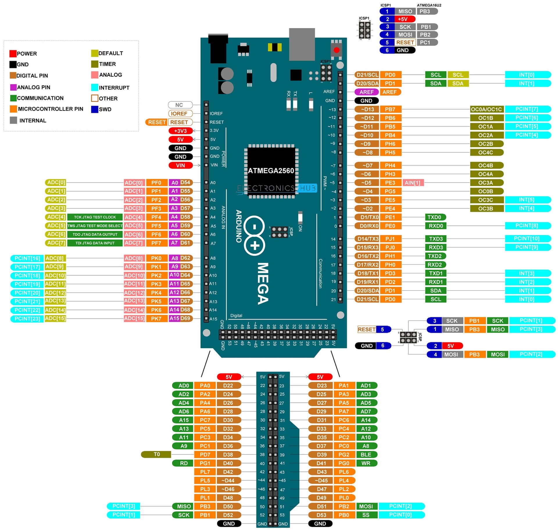

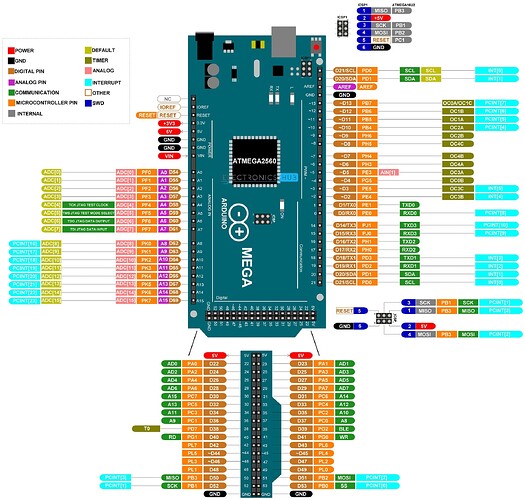

Are you sure your DFPlayer and serial port on your Arduino board are working?
On the arduino I don't have any doubts on the df player not so much. I will change it to Serial1 and report back in the afternoon. Which where the pins for serial1?
If your clone has the same microcontroller as the Arduino Mega, here are the pinouts.
RX1-TX1 = Serial 1
RX2 -TX2 = Serial 2
etc.
Yes, it is the same, I have the same board
