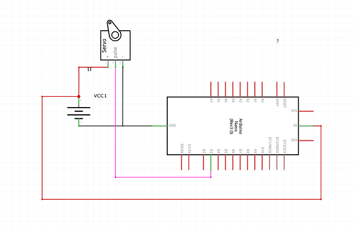

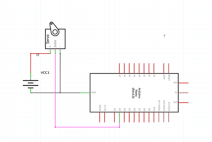

Your diagram shows the servo attached to pin 2
Which one, if any, is correct ?
Typo? Diagram I’m looking at says 3.
How the arduino board is powered?
Well spotted
The diagram does, indeed, show the servo connected to pin 3
The comment is wrong.
From what I have found D3 is pin 6.

As @UKHeliBob pointed out, your circuit diagram does not match your code. So first change your physical servo signal connection to UNO pin 6, not 3. **
And, unless your servo is a low power 'hobby' type, with no load on its arm at this stage, power it separately as @b707 said.
But what exactly do you want the servo to do? At present you haven't given it a single instruction to move.
** Edit: Or 3, but be consistent.

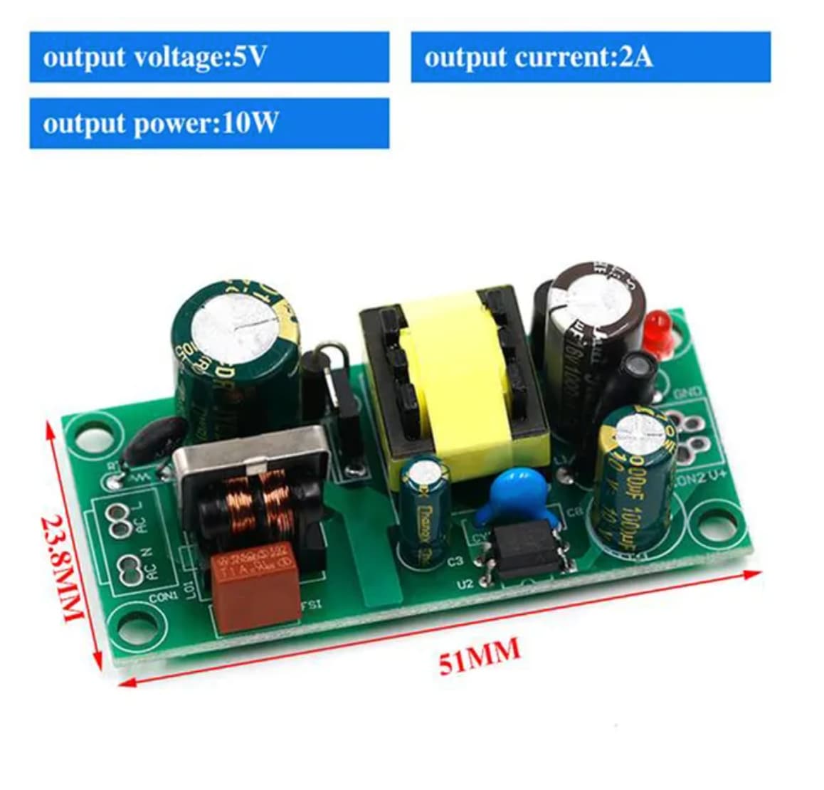

Is it ready-made product for DIY applications?
What's the principle behind it?
via relays, the pump and motor only run in one direction.
Does the noise get back through the small transformer like this one?
So I power the device from 220V mains and put two of these transformers to get 5V DC for Arduino and servos/motors?
