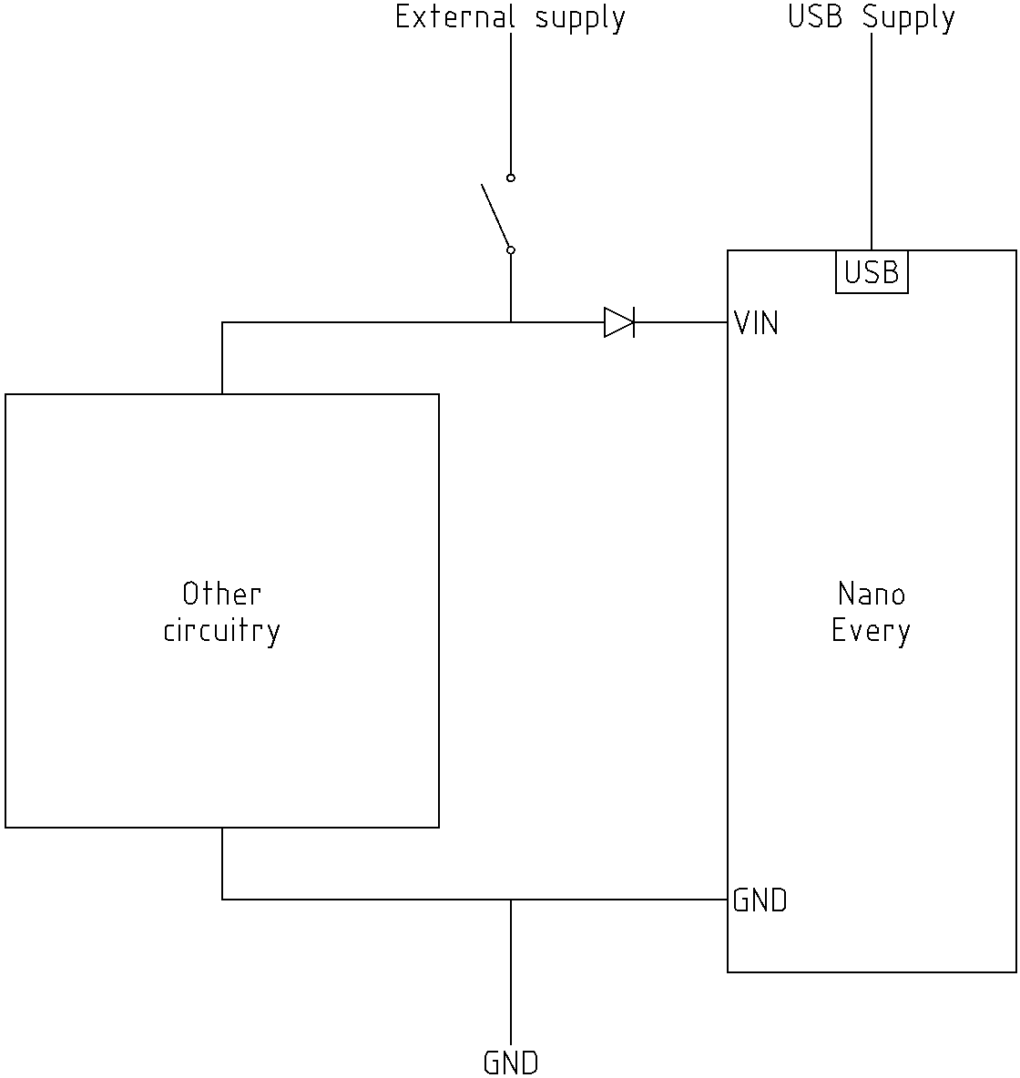

When using the Nano Every with external power and USB connection (control from PC or updating), you should be aware of a vulnerability of this board.
The 5V voltage regulator allows for reverse current, which might destroy it.
But protection is possible.

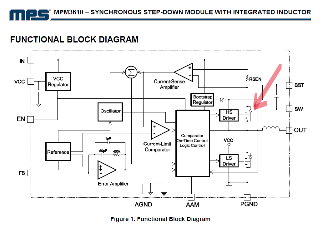

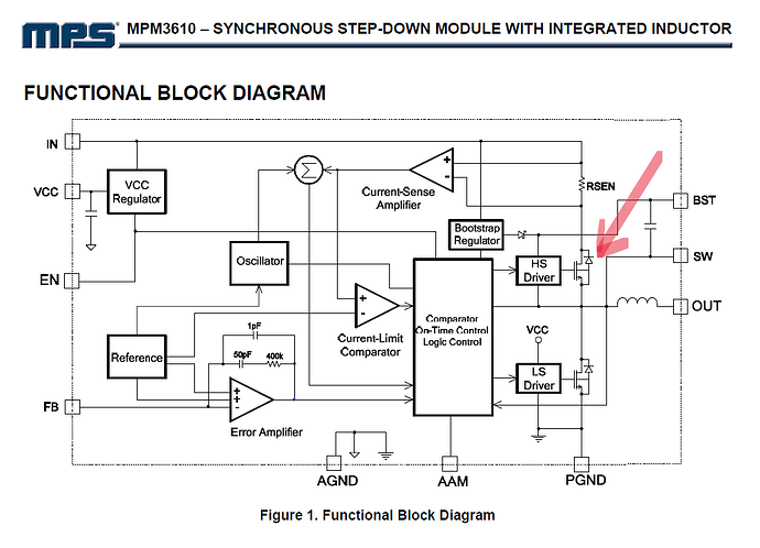

Can you show where that is?
This is the part that will be destroyed.

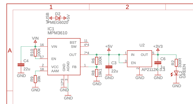

That isn't in any Arduino doc'n I have seen, please provide link.
Datasheets of discrete transistors often describe the properties of the reverse diode (aka body diode). I've read quite a few of them for selection purposes, noticing that the stated max current for this diode is either equal to the forward current or considerably lower. Sometimes, in the device description, the manufacturers explicitly mention adding a diode to the device, so I guess it makes a selling point.
The manufacturer of a DC/DC converter might consider adding a diode for protection against this reverse current, but that would affect the numbers for efficiency. Circuits using multiple power sources are rare, so I guess the efficiency is prioritized as a selling point.
Datasheets for complex devices are often tens or hundreds of pages long, even with omission of properties that are deemed unimportant.
I've read several threads on this forum mentioning failures of Nano Every boards. Analyzing the circumstances described, this 'reverse' diode is the most likely culprit. Simple measurement with a multimeter confirms its existence and the lack of any other safety mechanism. "If all other possibilities are rejected, the remaining one, however improbable, must be true."

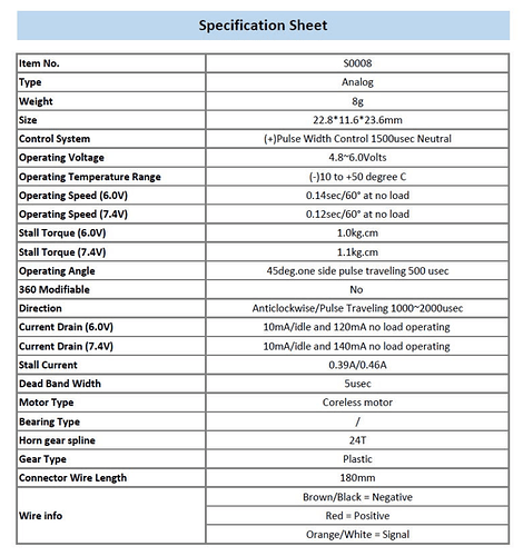

I found a datasheet of a servo that is more or less comparable:

Post #5 states "in the neighborhood of 1A". Someone from Adafruit said 500mA.

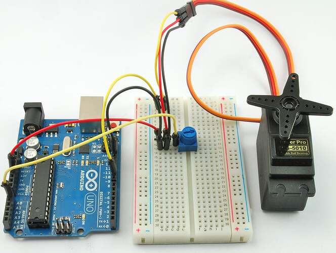

The general advice is not to use a board as a power source. Not because it is impossible but because it easy, and it is easy to damage the board if you don't regard the limitations. Still, having given that advice, they teach you power a servo from your board:
So, if you are careful about the limitations, things are possible (sometimes, and at your own risk).
