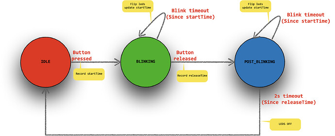

you might benefit from studying state machines. Here is a small introduction to the topic: Yet another Finite State Machine introduction
the state machine would look something like this
I'd suggest you use a button library such as Button in easyRun or OneButton or Toggle or EasyButton or Bounce2 to handle the button press.
