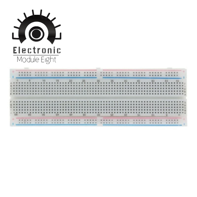

Rather than going into all the detail (including the hot melt glue), the better advice is to use a system developed for the purpose of experimentation, which means soldering "header" pins to the board and mounting it either in a "solderless breadboard", an "expansion shield" or a "screwshield".
