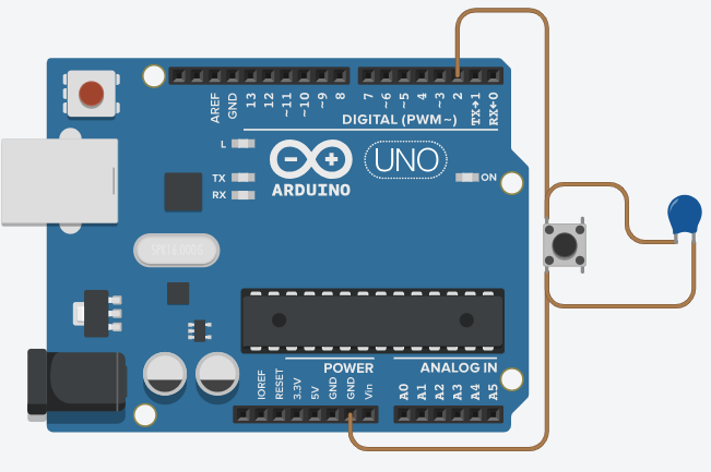

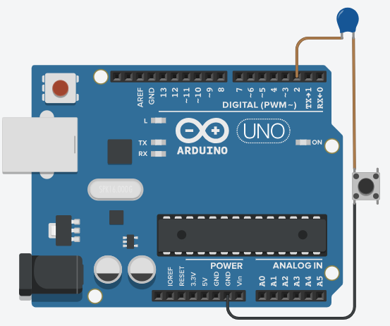

I will try to illustrate a little better here below:

to form a RC low pass filter for that pin
So, you mean like this?
Or like this?
should be

Yes. But I see no external pullup resistor?
Sorry, I missed this when drawing.
In resume: I need to use this schematic and change variable to volatile? Is that right?
Have you really got the pullup connected to Vin ?
How is the project powered ?
I don't recommend connecting the pull up resistor to Vin. Regardless, whether it's connected to anything or not.

There is no need to ever detach an interrupt, especially in the loop function which starts with attaching an interrupt pin. And even this should not be in the loop function but in the setup function.
Also bush buttons like this should be wired across the diagonal to prevent any doubt about the orientation of the switch.
We only know what you tell us about your project d you are telling us very little. And half of what you have told us is wrong.

So the way you do this is to write a minimal example that shows the problem, and then post all the code and a proper diagram.
So, nothing in any of the "schematics" you posted was correct.
If you use pencil and paper for the schematic, a square can represent any microprocessor. Label the pins, parts and connections clearly and correctly.
