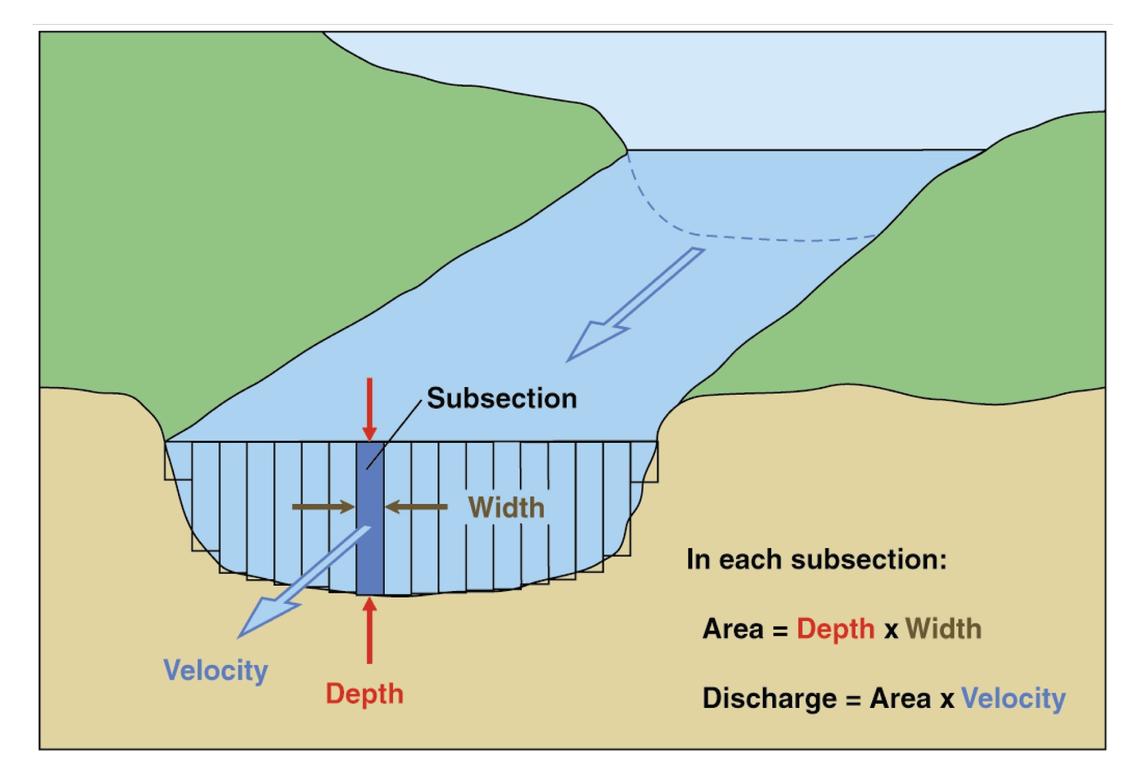

https://va.water.usgs.gov/online_pubs/OFR95-713rev.html#:~:text=How%20Does%20the%20USGS%20Measure%20Streamflow%3F%20In%20order,that%20passes%20a%20given%20location%20along%20a%20stream
How Streamflow is Measured

Then a flow speed sensor won't be sufficient. Water volume flow = area x velocity, usually measured in sections and totaled.
If you have access to a weir with rectangular opening, this makes the calculation much easier, as you need only measure flow velocity and water height in weir.
Yes, I need the cross section of the stream (area). I plan to use an ultrasonic sensor to measure it

The flow rate varies across the stream, from negative in vortices or zero at the margins.

And the way the USGS measures stream flow will not work for your situation?
