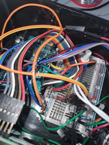

Forgot to mention it's an Arduino Uno. Yes mainly jumper wires. The current source and some connections for the LCD display (resistor, pot, 5v connections) are wired on a breadboard. TIA circuit is the only soldered part. Ill try provide a schematic soon, but its a bit messy so might take a while.

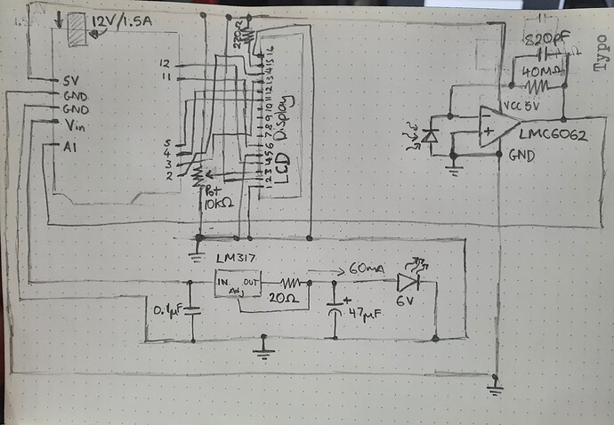

Here's a crudely sketched schematic, hopefully its alright. Not sure if the order of parallel connections matter in these drawings. Either way on the actual breadboard the Jumper wire to the TIA Vcc is the first connection contrary to the sketch.
Show us the breadboard setup.
Does the TIA have it's own ground connection to the Arduino (not shared with LED/LCD ground).
I don't see any decoupling on the LM6062's supply.
The Uno has a ratiometric A/D, so no good to measure "voltage" from a TIA.
You can fix that by connecting the Aref pin to the 3.3volt pin, AND use this line in setup().
analogReference (EXTERNAL);
Must do BOTH, otherwise you will damage the Uno
Now 0-3.3volt from the TIA returns 0-1023, and this should now be independent of Arduino's VCC.
Leo..
Connect the LED supply directly to the 12V SMPS.
Give the 6062 a separate 5V supply.

Output of a ratiometric A/D depends on input voltage AND reference voltage,
which is good if you are using a ratiometric sensor that also has it's output depending on supply voltage. Supply variations then cancel each other out.
But the output of a TIA is not ratiometric. It's output only depends on photo current.
For that you need an absolute A/D (with a stable reference voltage).
The easy way, without adding extra parts, is to use the 3.3volt supply of the Uno,
because it's stable and not used for anything else.
Clipping (1023) of the A/D now occors at 3.3volt, which shouldn't be a problem.
Leo..

Connect the wire that is on Vin and the gnd for the LED circuit, directly to the 12V 1.5A supply.
This will keep all of the LED current away form the UNO pcb tracks.
The LM317 is dissipating ( 12 - 6 ) x 0.06 = 0.36W, depending on the package of the 317 that should be okay.
How should I power the Arduino then?
As you have been with the 12V supply.
What I am suggesting is you divert the LED current AWAY from the UNO PCB.
