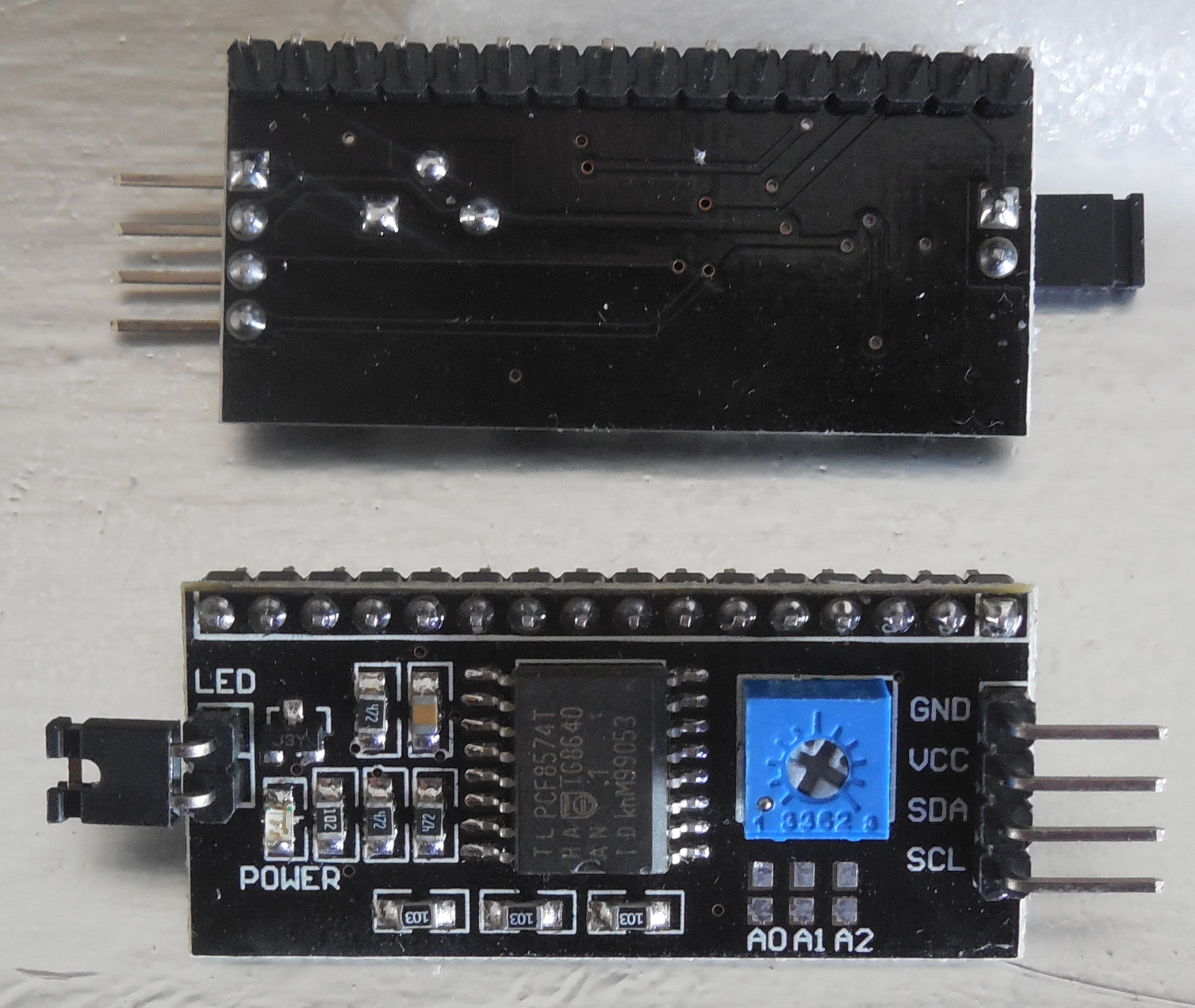

Newbie, but did my homework. Using Arduino Uno R3 2012 & 4x20 LCD w Backlight & cheap I2C adapter.
Kudos to fm on her marvelous library and to bperrybap for his contributions to it.
Is it possible to get a "sticky" attached to the subject of "New LiquidCrystal Library" that will make reference to this library more convenient?
Can someone of influence lobby for fm's library to replace the standard library?
Now to my problem:
I bought 3 I2C adapters for $2.29 each on ebay. (See attached photo).
They work great with fm's library using the following constructor:
LiquidCrystal_I2C lcd(0x27, 2, 1, 0, 4, 5, 6, 7);
No other libraries worked (I tried all that I could find). Learned a lot in the process, so it was worth the effort.
The only examples I could find for turning on the backlight involved using Arduino pin D13. I tried to understand what was being done, but I couldn't see how the backlight() command was doing anything but using an additional wire to control the backlight by means of Arduino pin D13. My major concern is that I don't want to create a dead-nuts short that burns out equipment.
How is it done using the built-in commands and the I2C buss alone?
Currently, I just bent pins 15 & 16 of the adapter out of the way before plugging it into the 4x20 LCD board. I soldered wires directly to pins 15 and 16 of the LCD board and attached those to pins D13 and GND of the Arduino board. Ugly, but it works.

If you look at your backpack,
See that 3 pin part over labeled J3Y over by the jumper?
That is a NPN transistor used to turn the backlight on/off.
Since you have not filled in the constructor with the backlight control information,
the library does not know how to turn on/off the backlight using that transistor.
If you will enter the full/proper constructor for the backpack, you will be able to control
it by using the backlight() and noBacklight() API functions.
You don't need to modify fm's library.
Just fill in the rest of the constructor with the backlight information and then
you can control the backlight in s/w.
The full constructor includes 2 more parameters, a PCF8574 pin number
used to drive the backlight circuit and the polarity of the signal.
You only have 1 pin that you haven't used, and the polarity is either POSITIVE
or NEGATIVE.
See the referenced i2c examples, or use the guesser sketch.
Note: you may have to play with the jumper as different boards have different circuits
and use it differently.
Here are some of the different combinations I've seen for the jumper:
  • Jumper on: backlight permanently on, Jumper out: s/w control
  • Jumper on: s/w control, Jumper out: backlight permanently off.
  • jumper on: backlight permanently on, jumper out: backlight permanently off
    (This last case is not your board since you have a transistor on your board)

The change to the constructor worked perfectly. Now that I know about the transistor driver of pin 13, I can unbend the pins on the adapter and toss the extra wires. Good news is: I learned a bunch about a bunch of stuff.
Thank you.

Unfortunately, that example is a poor example of how to use the library.
It is for fm's Electro Fun Extra i/o board.
fms' extra i/o board doesn't have backlight control circuitry so the example uses a separate arduino pin
to control the backlight. (It uses I2C and extra Arduino pins for backlight and constrast control)
It also doesn't specify the pins so it uses a default wiring which is for fm's board.
So unfortunately, it is not the way the i2c interface works on all the other
i2c backpacks out there with backlight control.
As far as examples go, I had assumed you read the full [SOLVED] MJKDZ thread, which is the
same thread where I posted the guesser sketch.
In the very first post of that thread,
Step #3 has the link to a site ( LCD-Blue-I2C page) which has information on
how to get the backpacks working and the i2c examples that use the full constructor.
Once fm's library added support for backlight control, the sketch should no longer
have to use pinMode(), digitalWrite(), or setBacklightPin() with the backlight pin.
Essentially setBacklightPin() became obsolete once the constructor was extended
to support backlight control information.
And if using I2C, you must use the full extender to tell the library how to use an
i/o expander pin to control the backlight circuit since the backlight circuit is not being
controlled by a pin directly connected to the Arduino.
The examples on the LCD-Blue-I2C page use the full LiquidCrystal_I2C constructor and the backlight
api functions.
--- bill

Actually John, I just looked at my interface board and it is identical. Since the backlight is driven from the interface board, I think that code should work for you. If not, let me know and I will point you in the right direction of the library I used.
The jumper should be left on.
The answer was:
Use the full constructor
LiquidCrystal_I2C lcd(0x27, 2, 1, 0, 4, 5, 6, 7, 3, POSITIVE);
lcd.noBacklight(); // turns backlight off
lcd.backlight(); // turns backlight on
Thanks for all the help, folks.
