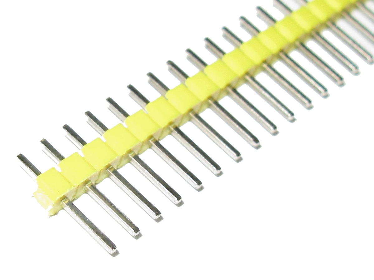

The Every has holes also - why not just use pin headers to connect it to perf board or whatever you are using?
Example
http://www.dipmicro.com/store/HDR40T-Y
I'm trying to get the lowest possible profile as the spacing is tight with my prototype so I'd prefer to use the castellated pins vs regular header pins.

Can you just use pins thru the Every and the perfboard without using the plastic housing that keeps the pins lined up?
Discrete pins,
https://www.digikey.com/en/products/filter/terminals-pc-pin-single-post-connectors/323?s=N4IgjCBcpgbAnABiqAxlAZgQwDYGcBTAGhAHsoBtEAVgBZqAmEAXRIAcAXKEAZQ4CcAlgDsA5iAC%2BJMPAAc8FCHSRs%2BYmUohkrEJ258hYySQC0TaEqgCAruvKQq1ECQXMpIEwovKbdzRDd3cyo2ETwWElhFQQATbhMwRAh2LkgQZxAOAE82Am4sPHQJCSA
Or break up a strip of pins and cut them short after soldering them in.
