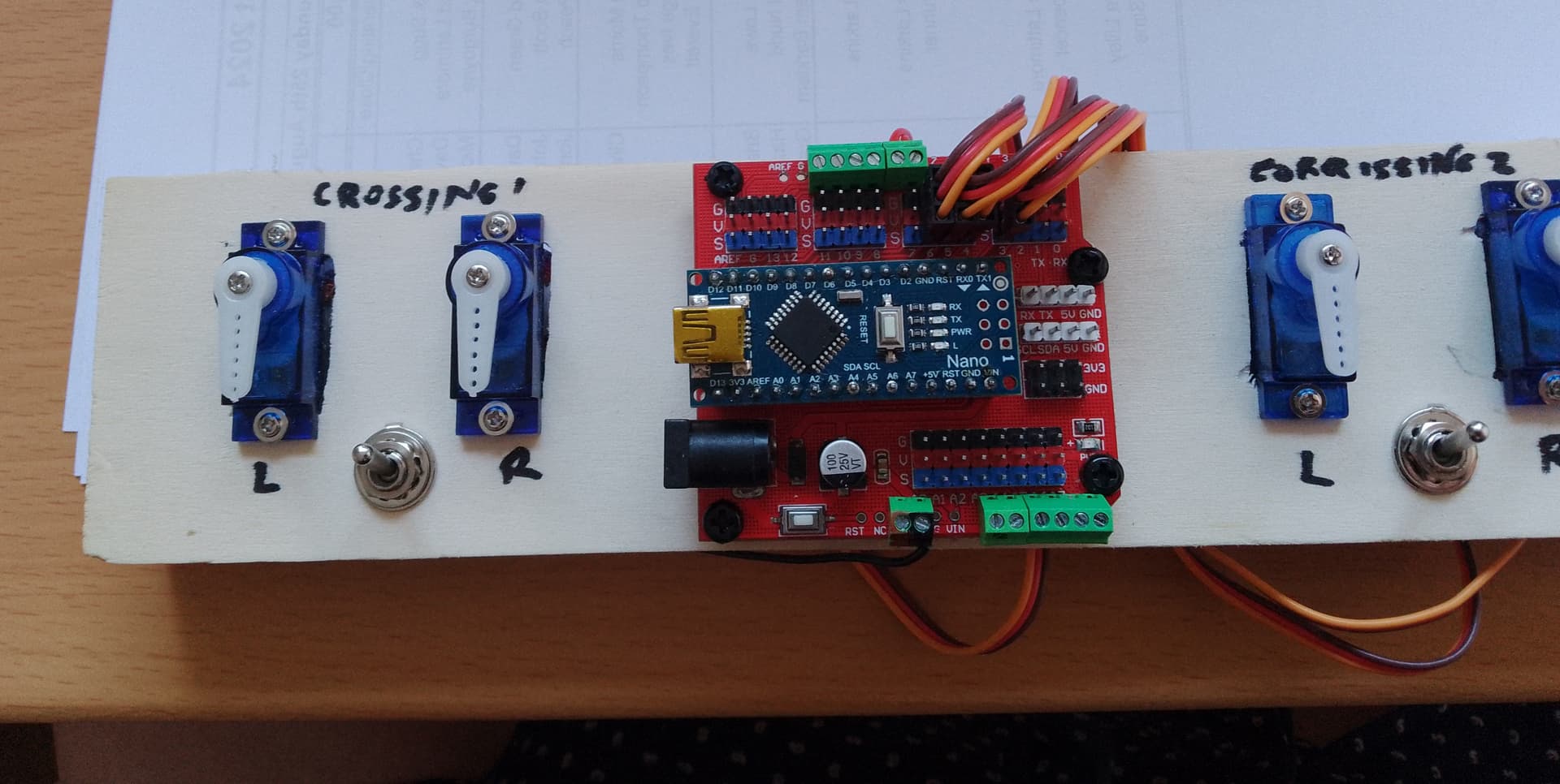

My guess: a wiring issue with servo 1.
Post a picture of your setup... maybe we can find what is wrong...

Try swapping the wires between the non-working servo and a working servo. This will help you diagnose whether the problem is with the servo or the Arduino.
