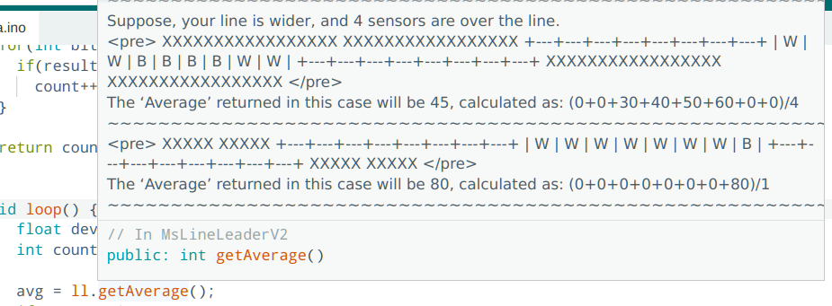

Hi, I am developing a library to use LEGO Mindstorms sensors with Arduino and mBot Ranger.
In Arduino IDE v2 my API comments are shown in pop ups which is great! However, I have an issue with formatting.
E.g. this comment:
		 * Average:
		 * The average is a weighted average of the bits set to 1 based
		 * on the position.
		 * i.e. left most bit has weight of 10, second bit has weight
		 * of 20.
		 * The diagrams below explains the line scenario and the
		 * Average returned.
		 * Suppose your line is narrow and only under the sensor 5.
		 * I.e. all the 8 sensors except the 5th sensor will return
		 * zero value. And the 5 th bit will be 1.
		 * <pre>
		 *                             XXXXX
		 *                             XXXXX
		 *             | W | W | W | W | B | W | W | W |
		 *                             XXXXX
		 *                             XXXXX
		 * </pre>
		 * The ‘Average’ returned in this case
		 * will be 50, calculated as: (0+0+0+0+50+0+0+0)/1
		 * Suppose, your line is wider, and 4 sensors are over the
		 * line.
		 * <pre>
		 *                     XXXXXXXXXXXXXXXXX
		 *                     XXXXXXXXXXXXXXXXX
		 *             | W | W | B | B | B | B | W | W |
		 *                     XXXXXXXXXXXXXXXXX
		 *                     XXXXXXXXXXXXXXXXX
		 * </pre>
		 * The ‘Average’ returned in this case will be 45, calculated
		 * as: (0+0+30+40+50+60+0+0)/4
		 * <pre>
		 *                                         XXXXX
		 *                                         XXXXX
		 *             | W | W | W | W | W | W | W | B |
		 *                                         XXXXX
		 *                                         XXXXX
		 * </pre>
		 * The ‘Average’ returned in this case will be 80, calculated
		 * as: (0+0+0+0+0+0+0+80)/1
		int getAverage(void);
is displayed like this:
clang-format does not break the comments, so this is not the issue.

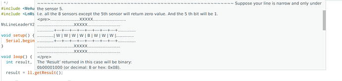

I tried to fix the line breaks using punctuation at the end of lines:
		 * <pre>
		 *                             XXXXX                         .
		 *                             XXXXX                         .
		 *             | W | W | W | W | B | W | W | W |             .
		 *                             XXXXX                         .
		 *                             XXXXX                         .
		 * </pre>
Next I tried to fix the formatting using dots instead of whitespaces:
		 * <pre>.......................XXXXX..........................
		 *.............................XXXXX..........................
		 *.............| W | W | W | W | B | W | W | W |..............
		 * </pre>
Actually what is needed is something like <pre></pre> in doxygen and others, which leaves the enclosed section unformatted with monospace font.
