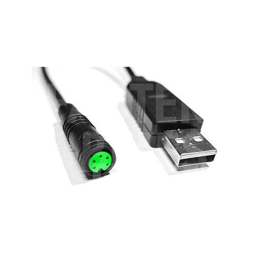

This is the type of cable used to program the ebike with:
Which uses a "USB to UART PL2303TA". And from what I understand that is 3V3?

joq3:
FasterBikes.eu | Programming cable for your Bafang Motor.
First you say CH340, now it's a PL2303.... But after a quick look it indeed looks like 3V3 or lower. BUT that is just guessing without more specs of that cable / measuring. As they also link to "fixes" it definitely does not use the official PL2303.
