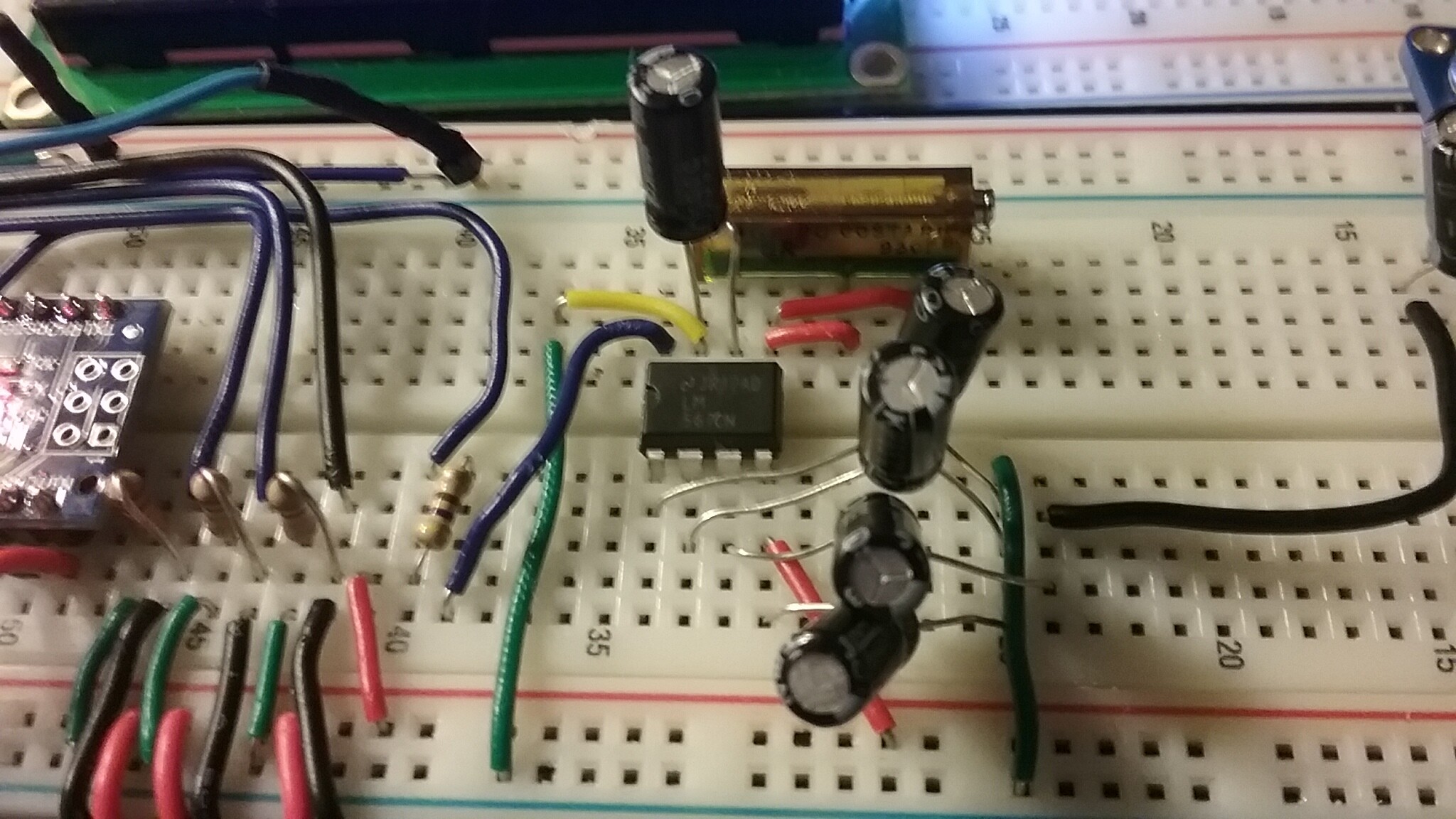

I have been able to successfully decode a tone with the LM567 IC. The tone is 2400Hz but with a 5k multi turn pot and a 10uF cap for C6 you should have no trouble hitting that frequency. I used the diagram from Scary Terry.
http://www.scary-terry.com/more_stuff/tonedet/tonedet.htm
Up to this point I have been passing the tone from an output pin on a nano straight into the chip. I've tried using the Adafruit gain mic and my circuit is not recognizing the signal the same as from the nano. Possible issues could be noise, voltage or amplitude differences. If anyone has experience they would be willing to share it would be great. I'm really new to all this so I don't have an scope to compare the signal from the mic to the one from the Arduino.

Don't be silly. When using an Arduino you bias the signals to 2.5V so it never sees negative voltages.
You said:-
This what actually i needed. i have an arduino + condenser mic which was connected to analog pin.
We all assumed you had done this correctly but is sounds like you haven't. You need a 10K resistor from the Analogue input to +5V, you need another from the same input to ground. Then you need to AC couple your audio signal into it. Which means connecting through a series capacitor.
The LM567 will quite happily lock onto a signal of 100 to 200mV. If you do not have that much audio signal then you have to use a transistor or op-amp to amplify it before the LM567 will lock onto it. No need to feed it through an Arduino first, that is just silly.
