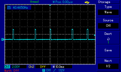

Frequency between each pulse varying (20 or 30 mSec)
I build a servo-tester using an ATMega328 (the programmer is Arduino as ISP). The space between each pulse is varying (2 x 20 mSec, then 1 x 28 mSec, and so on, on the oscilloscope). Is there a bug in the Servo library ? I use the port 8,(pin 14 / PB0). I only use the myservo1.writeMicroseconds(valeurDisplay);(The pulse width works correctly, it is controlled by a potentiometer.)
Any idea ?
Thanks for your help

I have to write that the intervalls between the pulse is 2 x 20 mSec, then 1 x 28 mSec, and 2 x 20 mSec, then 1 x 28 mSec again forever. It seems that the 2 x 20 mSec can be 3 x 20mSec, or 4x 20 mSec or more. I cannot find this varies.
Thanks for your help.

So, you’re doing an analog read, mapping that to a servo us, and writing that. No big deal there.
I’d suggest that something is delaying your timer1 interrupt, which is what Servo.h is using for the servo pulse train. So, we need to see what that might be. Since the loop() code just calls a function, and that function has not been provided, I’m out.

I solved the issue by removing the noInterrupts()and Interrupts() in the file HW_AVR.h, in the function OLED::update().
Sorry for the disturbance.
