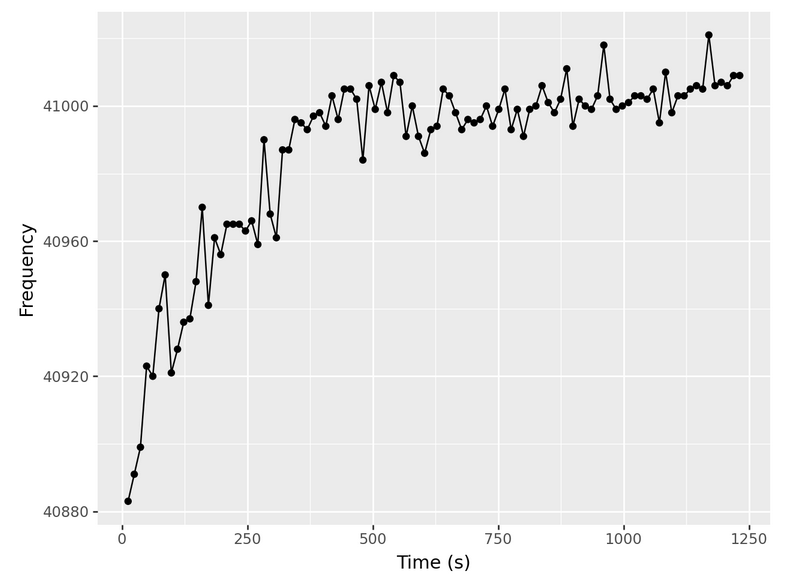

Hello, I am hoping someone has insight into what might be causing a phenomenon I cannot explain!
Here is the basic setup:
  • I am using an Arduino Nano clone (from Elegoo) to turn on an infrared LED by setting digital pin 2 (in output mode) to HIGH.
  • I then use an OSRAM TSL237 light-to-frequency converter to measure the intensity of the LED output. (The ultimate intent is to pass the infrared beam through a sample to measure the clarity of the sample.)
  • To measure the frequency of the signal from the TSL237, I am using the ATmega328P's timers (either timer 0 or timer 1 on input pin 4 or 5, respectively) to count pulses from the TSL237.
  • I use internal timer 2 to measure 1 second and count pulses from the TSL237 using either timer 0 or timer 1 during that time, which provides a direct measurement of the frequency of the signal in Hz.
So that's the basic setup. (I'd be happy to provide more details if they would be useful!) It all works well except for one phenomenon I cannot explain. After turning on the device, the measured frequency increases over time for about 8-10 minutes and then stabilizes. Here is an example of typical frequency measurements, at approximately 12-second intervals, after startup:
I am currently unable explain this behavior. Here's what I've tried:
  • I suspected this was somehow linked to the temperature of the MCU, so I added code to pull the temperature reading from the ATmega328P's internal temperature sensor. Sure enough, the curve looks about the same, and if I do a simple linear regression of the frequency measurement and the MCU temperature, I get R^2 of 0.8-0.9. So that seems to strongly suggest this is somehow caused by the temperature of the MCU.
  • After discovering that, I wondered if the change in measured frequency could by caused by the Nano's ceramic resonator heating up, which would cause its frequency to decrease. If so, that would explain the artifact of getting higher frequency readings with hotter internal temperatures: the duration of a second, as measured by resonator ticks, would increase, leading to higher frequency readings. To test this, I hooked the Nano's timer input to an external signal source that should have been stable (a 250 kHz PWM signal generated by an Arduino Uno R3 that had been running for ~10 minutes to ensure temperature stabilization). To my surprise, the relationship between the Nano's internal MCU temperature and the measured frequency disappeared. The Nano measured a fairly steady signal frequency of ~250 kHz the entire time! So that seemed to disprove the resonator hypothesis.
  • Next, I wondered if maybe the voltage of the pin I'm using to turn on the LED (digital pin 2) was changing as the MCU heated up, causing the LED output to change. Very unlikely, I know, but I hooked up a multimeter to the output of pin 2 to check. It read a voltage of 4.76-4.77 V the entire time.
At this point, I am at a complete loss for what to try next! The TSL237 and infrared LED are both far away (relatively speaking) from the Nano, so I don't see any way temperature could be affecting them. Regardless, according the TSL237 datasheet, its frequency output is quite temperature-stable and actually decreases slightly with increasing temperature.
I've confirmed that I can effectively "solve" this problem by letting the device warm up for ~10 minutes before taking frequency measurements, but that is obviously not very satisfying!
I suspect I'm overlooking something obvious, and I'd greatly appreciate any suggestions for where to look next! Thank you!
The frequency you are measuring is determined by the TSL237, which has a temperature coefficient, while the time base used to measure the frequency is the resonator or crystal on the MCU board, which has a different temperature coefficient.
Various effects determine the intensity of the light emitted by the IR LED: power supply voltage, LED current and LED temperature. So, you have a lot of possibilities to consider.

I agree that a crystal would be better than the Nano's ceramic resonator. What I cannot explain, though, is why I see the "warm up" effect of an initial increase in frequency measurements when I use the IR LED and TSL237 as the signal source, but I do not see the initial increase when I measure an external signal source. If the resonator were the problem, I'd expect to see that initial increase in frequency readings either way, I'd think?
That makes sense! In this case, the IR LED and TSL237 are distant from the MCU board (separated by ~12 cm of wire), so I wouldn't expect the LED or sensor to be affected at all by heat from the MCU board, but I could be wrong!

I am using an Arduino Nano clone. According to the ATmega328P's internal temperature sensor, the MCU does warm up by about 4 C after power up. Here are example data, collected at the same time as the frequency readings I shared in my original post:
As you can see, the curve is almost identical to the frequency reading curve, which is what led me to believe that what I am seeing is somehow linked to MCU temperature. I just don't know how!

Map the two on the same graph.
The Y scales are wildly different so I can't very easily plot the curves on the same graph, but here they are side by side, in case that is helpful:
The curves are not identical, but if I do a simple linear regression of those two variables, R^2 = 0.89, which is a good indicator of how closely they correspond.

Translate temp range of 47 to 51 into 0 to 100.
Translate freq range of 40880 to 41030 into 0 to 100.
Time will be the same.
Arduino has the map() function to do this.
A spreadsheet should be able to plot two sets of data on the same graph.

True, I could scale the variables to plot them together, but then unit information is lost and I'm not sure it'd be much more informative than the visual comparison you can already do with the side-by-side graphs? Here is another option for plotting the two variables together on the same graph:
Here, you can easily see that the two variables are strongly linearly related, which the statistical analysis confirms: either variable makes an excellent predictor of the other.

Its certainly strange, but I dont believe because there is some correlation between the graphs that that impies cause & effect. I think you need to look elsewhere.
I note the data sheet says the sensor is for uv and visible light, and you are using an (unspecified) IR LED.

I could certainly normalize the variables and plot them on the same graph, but it's not clear to me what that would reveal beyond the plots and statistics I've already shared, which unambiguously demonstrate a strong linear relationship between MCU temperature and frequency. I'm sorry if I'm missing something here!
You certainly are missing something, starting with the fact that a "strong correlation" proves nothing, and continuing by not considering more sensible alternatives.
