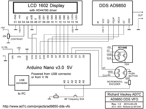

I am trying to plot the frequency response of amplifier automatically using DDS AD9850 as a function generator and interface it with Arduino UNO. I downloaded the code and library for the same from Arduino tehNiq: Signal generator with AD9850 and Arduino
Now the problem I m facing is, I am able to see the changes in frequency on LCD when i rotate the rotary encoder but the same changes are not visible on CRO. I get a constant Frequency irrespective of the changes i make in the rotary encoder. Also, this is manual updation, how can I go for automation in this system?? I don't know much about coding
please can anybody help me in generating frequency pulses to program DDS AD9850?? I will attach the code I used for programming DDS.
Please help!!
Thanks in advance,
Arpita

And the circuit you are using please - something is failing in the communication to the chip
by the sound of it, that could hardware or software...

hi
I am sending the circuit schematic, i used Arduino UNO and removed the frequency shift connection.
Thanks
Arpita
You have variables that need to be volatile because they are used in an ISR. Any multi-byte
variable changed in an ISR should only be read in a critical section in the main program.
That means disabling interrupts, then reading it (each byte is read separately in an 8-bit
microcontroller), then re-enabling interrupts:
noInterrupts ();
long my_rx = rx ;
interrupts () ;
if (my_rx != rx2){
showFreq(my_rx); // modify this function to take rx as a parameter
sendFrequency(my_rx);
rx2 = my_rx;
