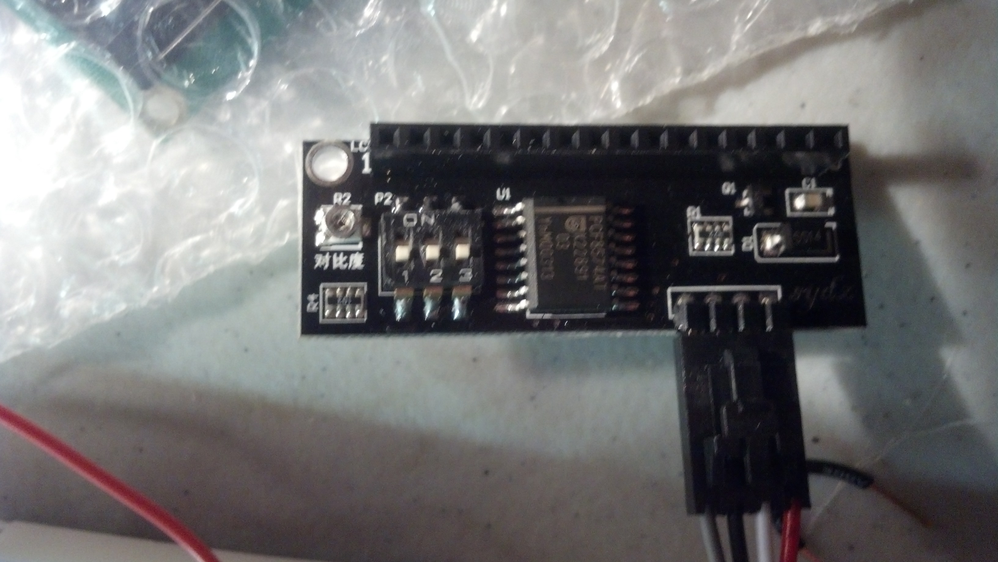

Show us a photo of the backpack you are using.
The last pin mapping you tried with the newLiquidCrystal library matches the pin mapping that I2CexpDiag detected.
The only difference is that since did not provide any backlight information in the constructor the newLiquidCrystal library won't allow controlling the backlight and due to the way the code works, it will set PCF8574 pin P3 (which is hooked to the backlight control circuit) to low.
If your backlight is on with that constructor, then the active level is LOW.
I2CexpDiag detected the active level as HIGH.
You should have seen the backlight blink with I2CexpDiag and you should have seen something on the LCD display as indicated in the I2CexpDiag output messages.

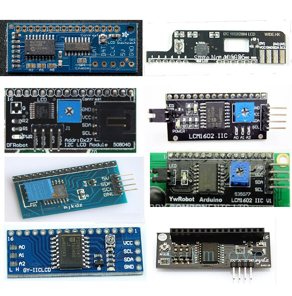

I have a few LCDs that I have soldered a 16 pin female header so it can be swapped between a few different backpacks.
It is actually needed/required on a few backpacks as they have the address jumpers on the side of the backpack that faces the LCD module.
I have one backpack that uses a 3 pin surface mount dip switch on that side so it also needs the header as there is no way to solder it directly to the LCD since it won't physically fit that way.
And a few have put the pot on that side (really dumb).
On those, I move the pot to the other side of the backpack to solder the backpack to the LCD.
There are some really bad/dumb i2c LCD backpack designs out there.....
--- bill
Yes, you can solder female headers on the backpack and male headers on LCD. Which lets you swap hardware combinations.
The regular punter just wants a backpack neatly soldered to the LCD.
David.
Here is an example of some of the different backpacks that are out there:
The sydz is by far the worst layout and design.
It uses a surface mount dip switch - so the backpack can't be soldered directly to the LCD
It has a surface mount pot on the side that would not be accessible if it were soldered to the LCD
It uses an FET so backlight auto detection by hd44780 will not work correctly.
--- bill
bperrybap:
Mind you, the FET is only a problem for your auto-detect code, otherwise it is an improvement. :grinning:
It can be soldered directly to the LCD. but you would be attaching it so it extends above the LCD. This is not quite as bad as it seems, since five of the others show the same stupid design fault - the I2C connectors project from the wrong end of the board causing the "Dupont" fitting to project out the side of the assembly.
The I2C connector should be on the pin 16 end of the board so that the wires fold under the LCD. :roll_eyes:
Yes an FET is actually better.

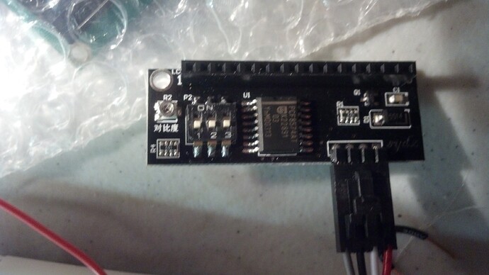

Although I actually misspoke on the SYDZ board. I went back and looked at it.
It is the SY1622 backpack that has the FET.
The SYDZ board actually has what I consider to be a broken backlight circuit.
They wired it up in a common collector configuration.
The collector is wired to VCC and the backlight load is between the emitter and ground.
This forces the base current to go through the backlight rather than straight to ground.
This "works" just not as well as when wired in common emitter configuration
where the backlight load is between VCC and the collector.
They also added a separate pullup on the base of the transistor.
I'm guessing this was necessary because the weak pullup on the PCF8574 use to create the high signals couldn't provide enough current to get enough gain from the transistor to get the backlight to turn on very bright.
This added pullup is not needed when the backlight is wired up in common emitter mode.
A side effect of all this is that with the pullup on the base, it won't to allow the hd44780 backlight level detection to work correctly.
