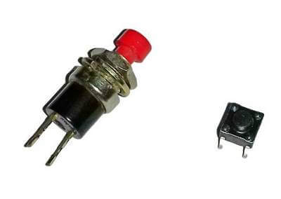

why do you make your life complicated with ports, interrupts etc... ?
can't you just use a button class (such as Button in easyRun or OneButton or Toggle or EasyButton or Bounce2, ...)
My buttons are in a button-class for exactly this reason. I neglected to post it to not bloat unnecessary, but here you go:
#ifndef button_h
#define button_h
#include "Arduino.h"
class Button
private:
    uint8_t btn;
    uint16_t state;
public:
    void begin(uint8_t button) {
        btn = button;
        state = 0;
        pinMode(btn, INPUT_PULLUP);
    bool debounce() {
        state = (state << 1) | digitalRead(btn) | 0xfe00;
        return (state == 0xff00);
#endif
strange and probably unreliably method to debounce buttons
You did not explain your reason. Or do you really mean you put the buttons into a button-class to make life complicated?
How should somebody carefully analyse a code if not all details can be seen??
Can you explain this to me??
Using serial print in a interrupt service routine shows that you are nearer to a beginner than to a professional code-developper.
Is this some kind of exercise trying to write code that uses interrupts in combination with 1. direct register manipulation ?
or
2. Do you just want to have some kind of functionality that is not highly time-critical?
If you want 2. = some kind of functionality where this functionality is not highly time-critical
start from scratch using standard commands like digitalWrite() and digitalRead()
best regards Stefan
