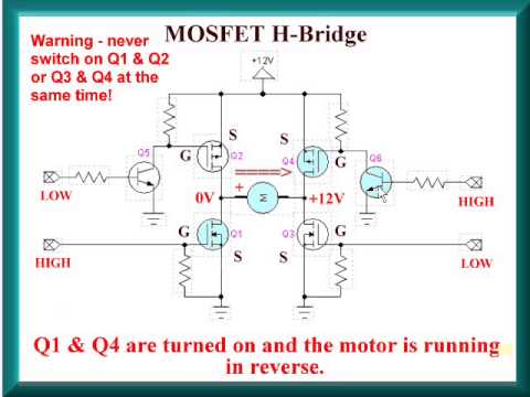

Get a driver that can do the work in the first place. 36V is too large to drive a simple MOSFET bridge, 12V its doable, any other voltage and you might as well build or buy a proper MOSFET bridge in the first place.
Pololu will have some suitable drivers - make sure they can handle peak stall currents and are rated at more than 40V if you need to run at 36. If you can run at a lower voltage (slower motor though) there will be more choices. The stall current will be less too.

I built an H-bridge using these logic level mosfets. These are rated for 60V/30A. SEE REPLY#6 DIY H-BRIDGE
I used these heatsinks ($0.40/EA) (drilled and tapped M3 thread)
Logic Level Mosfets

If you dropped the operating voltage down to 24v, you might be able to use an h-bridge like below. The dish actuator might not last long trying to move your gate.
http://www.ebay.com/itm/Semiconductor-BTS7960B-43A-Stepper-Motor-Driver-H-Bridge-Drive-For-Arduino-YUUS-/161807192765?hash=item25ac75d2bd

Use a relay for forward/reverse, and a single mosfet for switching.
The relay contacts might also be used for motor braking.
