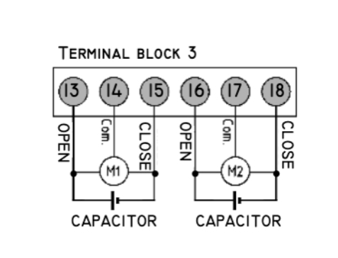

The motors are working. How they're working is fairly simple: they both have 3 wires:
  • Brown
  • Blue (common)
  • Black
    Then there's a capacitor for each of the motors, each with a white wire and:
    Brown + white = opens the gate
    Black + white closes the gate
There is also a photo cell that detects movement so it prevents the gates from closing when something passes in front of the cell while the gates are closing. I can stop using this if it's overly complicated to integrate it.

Your drawing shows a COMmon and ‘open’ /‘close’ connections…is that correct, or is it neutral and two actives, or ground and ???. This is important.

OK, we’re getting there…

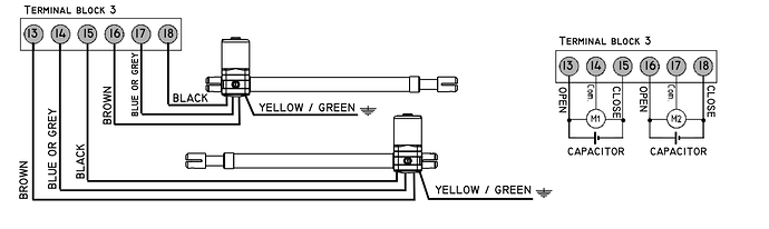

My question about the motor wiring was because of this image…
The placement of the capacitors specifically requires the inactive winding to be open… just checking.
Ok, then all you need is simple ‘insulated’ relays feeding the four driven windings.
It may be worthwhile to cross-wire the contacts, so that in a failure, both open & close windings of a single motor can’t be energised at the same time.
Control is relatively trivial… a simple MOSFET driving each of the relays as required for proper operation, and the photocells, limit switches and go/stop buttons are straightforward.
Keep in mind the possibility of the wiring being damaged, or a switch/sensor failure to make the controller fail to a safe mode.STOPPED !

These are the specs written on the motors. I will do my best to find out the whole schema of the current system.
There is a broad explanation of how the current system works in this manual.
Not quite, they are 2phase motors.
Using this diag,
42055CC4-CCF5-4DE3-B0E1-0FE6FB164E54
You supply AC Neut to pin 14, if you then supply AC Active to pin 13, the left coil is in phase with the mains, but the right coil, supplied by pin15 receives current phase shifted by the capacitor.
And so rotates say CW.
You supply AC Neut to pin 14, if you then supply AC Active to pin 15, the right coil is in phase with the mains, but the left coil, supplied by pin13 receives current phase shifted by the capacitor.
And so rotates say CCW.
What you must realise is that pin 13 or pin 14 when not connected directly to active is still every much alive due to the capacitor.
