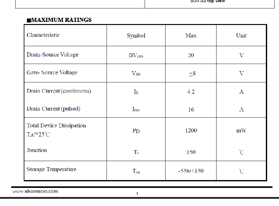

Hello,
I'd like to use a MOSFET in my circuit (as a switch) but I'm just not sure about something in the datasheet of the MOSFET I plan to use.
As you can see, in the maximum ratings panel, it says that the maximum gate-source voltage is around 8V an that maximum gate threshold voltage is 1.2V.
Does all this mean that it takes 1.2V to saturate the transistor and that from 8V, there is a risk of burning the transistor?
I ask this question because I would like to control the gate with arduino pins (which are therefore at 5V).
Thank you already to those who will take the time to answer :slight_smile:
You can check the datasheet screenshots here (the images don't load):

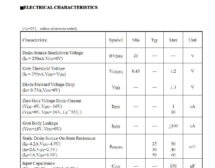

The threshod voltage is the gate voltage at which it is deemed that current begins to flow, not saturation. You really should use a logic-level FET.
The maximum gate-source voltage is a voltage at which (or possibly above) damage may be done to the FET.
DO NOT REACH OR EXCEED THIS VOLTAGE !

It would be easier to just tell us which mosfet you're using. We can look up the datasheet.
Anyway, the threshold is the gate voltage at which the mosfet just begins to conduct. The voltage at which it's fully turned on will be significantly higher than that, and depends on the voltage and current you need to switch, the temperature, etc. But I think a mosfet with a threshold that low would certainly work with a 5V Adruino, and even a 3.3V Arduino.

The absolute maximum Vgs is +/-8V. This means the device may destroy itself instantly if the gate-source
voltage every reaches of exceeds 8V in either direction (typically it will take more voltage than that, but this
is for any device from any batch).
The threshold voltage is nothing to do with using the FET as a switch, ignore it. Its not a maximum its a "typical" value.
No and yes.
The only spec you need to be aware off for switching is the on-resistance table in the second of your links.
This lists the guaranteed on-resistances for several possible gate-source voltages, this is what you need
for using it as a switch. This device is definitely logic level, will work from 5V, 3.3V or even 1.8V logic.

Note that the static drain-source on state resistances are specified at logic levels, so this is a suitable logic-level device. At 1.8 V on the gate and drawing 4 Amps, the 60 milliohm resistance would result in a dissipation of just under 1 Watt, so driven by a 5 V Arduino and for a lesser current, heatsinking should not be a problem.

As per my calculations in #11, even small resistances result in significant dissipation with large currents. The SL2300 is tiny and I would be concerned about it dissipating one watt.
