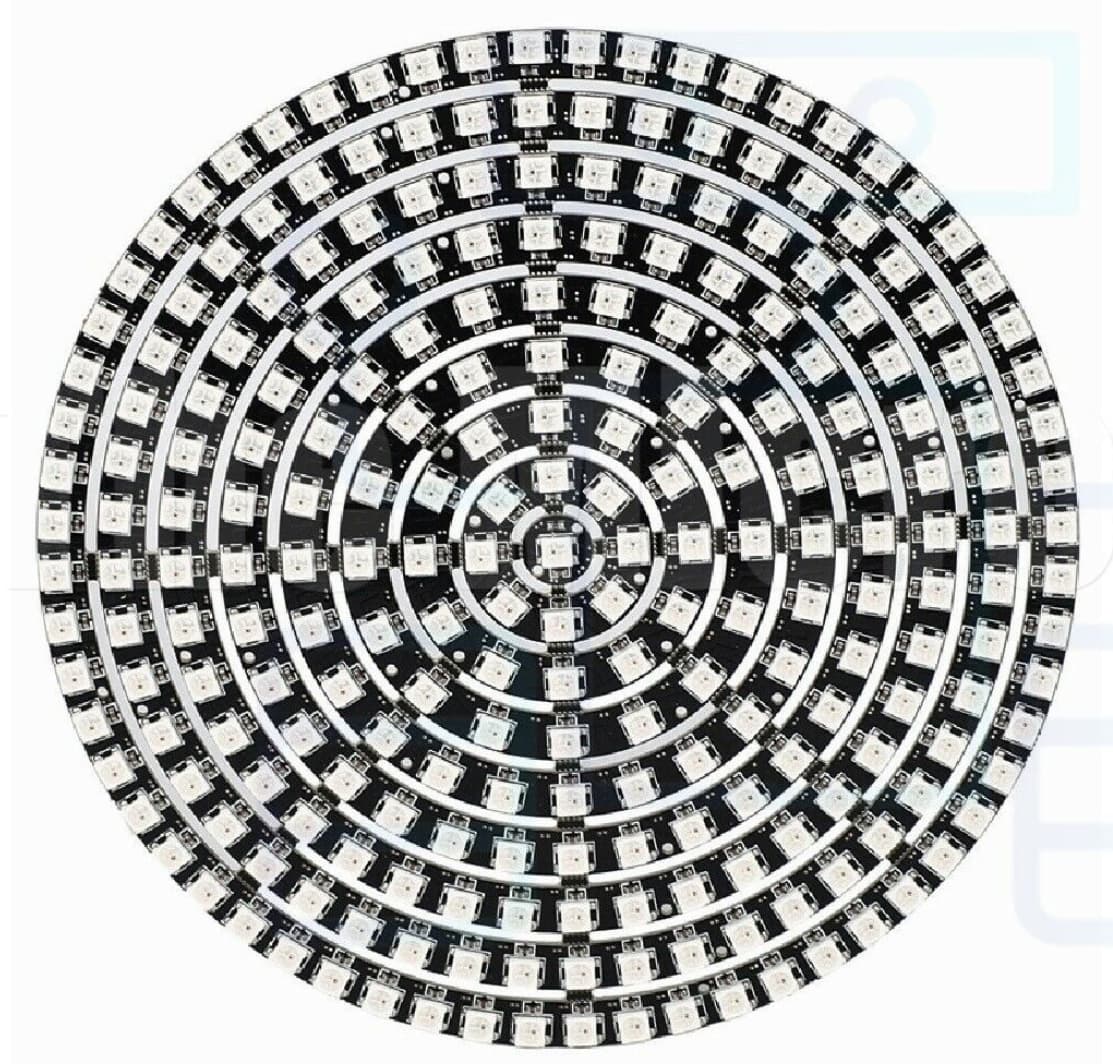

Can you post the picure of your setup to show the relative positions of the ledstrip and ledcircles?
Are your four ledcircles are like this (Fig-1)?
circlesleds
Figure-1:
not sure why this matters for the code :slight_smile:
I have few of these addressable LEDs and wish to duplicate OP's setup so that I can execute OP's sketch and suggestions of other posters.
it's probably more like this (just a guess)
That is a real one!
OP is saying that he has four circles with 7 LEDS having one in the center and there are four driving DPins; accordingly, I have chalked out the diagram of Fig-1 of post #5.
I think it's four times one like this
That one of post #10 contains cascaded LEDs in two circles and one DPin is enough to drive it. OP is saying that he has four driving DPins.
he has 4 independent Neopixels rings, each being their own strip rather than being cascaded
Sometimes, it is difficult to convert text into pictures that really exist; that's why I have wanted to see OP's setup.
here is a picture that represent the text as I understood it
each strip is independent, as seen in OP's code.
This makes sense to me.
Thanks a lot for the patience to understand what I have been looking for. I don't have
pre-fabricated rings like these; I have to make them from single pieces and joining them together.
they are quite frequent and come in multiple sizes and you can indeed build some kinds of disk if you buy units of different sizes
Ach, I’m new to this forum so I’m not so familiar with all the interface. Anyway, J-M-L’s diagram is my exact setup. I got rather ambitious in upgrading my Proton Pack and got those circle LED lights because they’d be brighter. I didn’t realize that there’s no simple “turn all the lights on in this strip” function which would let me treat them like single LEDs.
what about the fill() function ?
Would making those copies, passing the objects by value, and overflowing the arrays make it easy to mess up memory and cause a hang?
Edit: Changing to the arrays and array access by index seems to work without hangs, vs the #1 code hanging.
