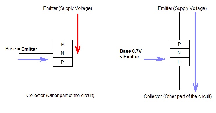

I dont really understand this.
What is the voltage on the base of the PNP transistor when it is fully on?
It is 0.7v lower than the Vcc. If you have that Vcc at 15V that puts it at 14.3V going into the output pin of your arduino.
Using a NPN transistor the base is just 0.7V off ground. That is why you have done switching before with an NPN.
my understanding is that the base has to be at least 0.7 lower than Vcc to be in a conducting state. if Vcc is 15, you can still put the base at 1v, so long as there's enough current flowing out of the base, into the arduino pin at ground, to put the pnp in saturation.
is that wrong?

That is right when the arduino is switching the transistor on.
But when the arduino tries to turn it off it puts 5V on the base which is still enough to send the transistor into saturation and also send your arduino to silicon heaven.
ohhhhh yea...i had to use an npn to turn on a pnp....forgot about that little detail haha. thanks.
