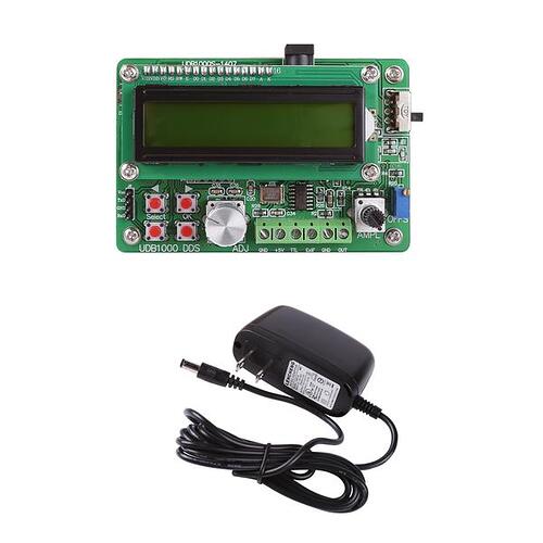

I have a stepper motor and I'm using the accelstepper library to accelerate and decellerate the motor so that it mimics the abnormal sine wave of a heartbeat or reading from an EKG. That's all fine and dandy. I want to now also take an output of this abnormal sine wave to use in data collection. I really need the reading in either the abnormal sine wave or an electronic signal that matches the abnormal sine wave in amplitude/intensity.
I found those two devices but it seems that it's not what I'm looking for. They produce signals but they seem to require manual input to change the output and not reliant on the arduino for production of signals. Any help would be appreciated, thank you
How does one "read a sine wave from the movement of a stepper motor"?

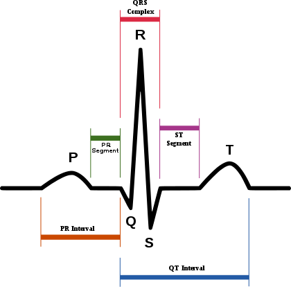

Was just a small proof of concept to show I could attempt to simulate the abnormal sine wave of the sinus rhythm. Basically I need the simulated sinus rhythm replicated as data that a machine can use to synchronize itself to the rotation of the stepper motor. This machine only takes inputs from an ECG/EKG so I need to convert the rotation of the stepper motor into a similar output of that of an ECG/EKG so I'm turning it into an abnormal sine wave. I don't want it to move with the ECG, I want the machine using the ECG reading to synchronize itself to the movement of the stepper motor so it knows where to look at each position of the stepper motor's movement. The reason I want the cam lobe is because I thought I could recreate such an output using the depression to recreate such a thing.
There's another recent post from someone trying to reproduce the electrical signals than an ECG is expecting. Are you two working together or in competition?
Do you know what voltage and current the ECG is expecting to get on its probes? Can you find out?
You can run the motor in a way that looks or sounds like a heartbeat but that's going to be very different to the electrical signal that the ECG is showing on its screen. Get the two parts running independently.

I'm still lost. What is the signal you want to generate?
A mathematical sine wave?
A mechanical equivalent of the electrical ECG signal?
Some other heartbeat motion?
So you know how as a point on the stepper motor shaft rotates in a circle it would take the form of a sinewave if you mapped its position vs time? And how an electrical ecg signal is kind of like that in that you can mimic the electrical signal by mapping a different objects position vs time? Well I want to map one point on the stepper motor as it moves through its rotation and take this data, turn it into a graph/signal that a computer could read. I can move the stepper motor in a way that slightly resembles an ecg signal. Now I want to map it so that the graph produced by recording the movement of a single point on the motor shaft is readable by a computer and interpreted as an electrical signal
In no way is this anything like a sine wave traced out by a rotating object...
(from Electrocardiography - Wikipedia)
