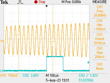

did you ever get the 20 kHz carrier modulated at 50Hz working?
using ESP32 with a AD9833 DDS module and a X9C103S Digital Potentiometer I get
zoom up to see the 20kHz carrier
1. Is your carrier wave bi-polar sine wave or uni-polar square wave?
2. Is your modulating wave bi-polar or uni-polar?
original is a uni-polar sine wave, e.g. AD9833 DDS 20kHz signal (blue line is 0volts)
is fed to the X9C103S Digital Potentiometer via a capacitor to give a bi-polar input signal
the X9C103S Digital Potentiometer then modulates the 20kHz carrier at 50Hz
