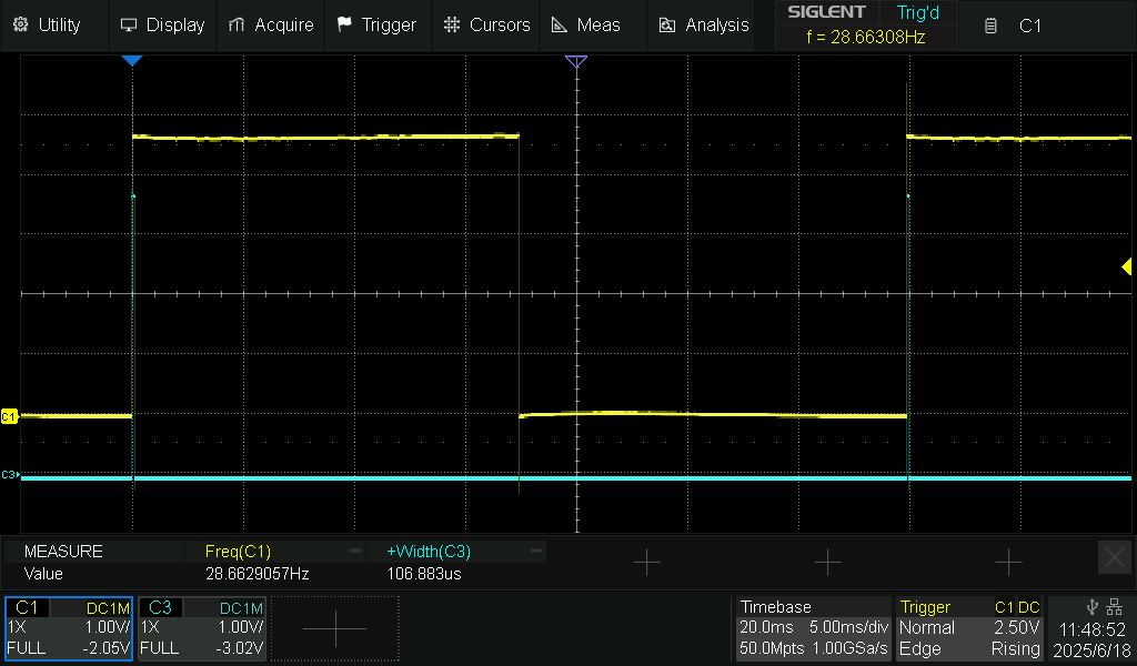

Your suggestion looked pretty close to me:

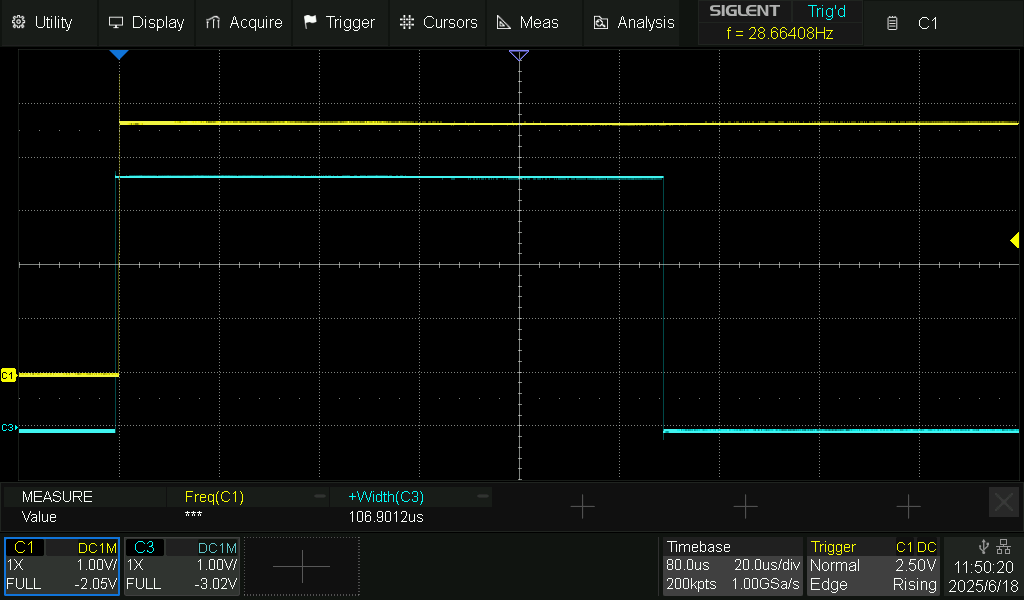

and the 100µs pulse on a faster time base:

Yes, indeed that was my first attempt and I could read the pulse on the oscilloscope every two or three rising edges of the square wave. I am starting to think the issue was with the oscilloscope and not with the code or the arduino...
I just checked again the code in my original post and it actually works as well (even though the frequency is not correct as it generates a 15Hz wave with 50% duty cycle).
