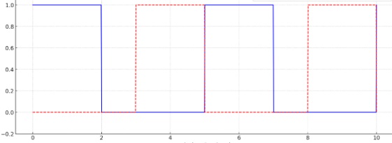

Hi there,

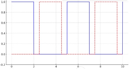

I want to generate two square waves with an Arduino Uno using Timer 1 at a frequency of 200 kHz. Both waves should have a duty cycle of 40%. The first wave should go high at the start of the first half-cycle, and the second wave should go high at the start of the second half-cycle. I wrote the following code. According to this code, the first wave works correctly, but the second wave goes high 10% into the second half-cycle and goes low at the end of the cycle.
I want the waveforms to be as follows.
Square wave1
But The following code generates the following picture:
Square wave2

I don't know how you would do that. You need to specify three points in the count - the end of the first wave, the beginning of the second, and the end of the second (which is not the end of the count). But you only have two registers. I think ICR only lets you specify the end of the count, but per your drawing you want the count to continue after the end of the second wave.
Isn't the net result of that a 400 kHz signal with an 80% duty cycle or am I missing something?
I don't think it is possible to do what you want with Timer1 on the ATmega328.

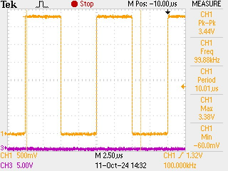

you could try using simple loops, example using an ESP32
however, the microcontroller is dedicated to generating pulses and unable to do anything else, e.g. reading sensors
as @jremington stated generating the pulses using the UNO timer may not be possible
you could try using ESP32 timer interrupts
EDIT: generate 100KHz square wave code updated to use ESP32 core V3.x
// ESP32 timer inteerrupts -   100KHz square wave print period counter

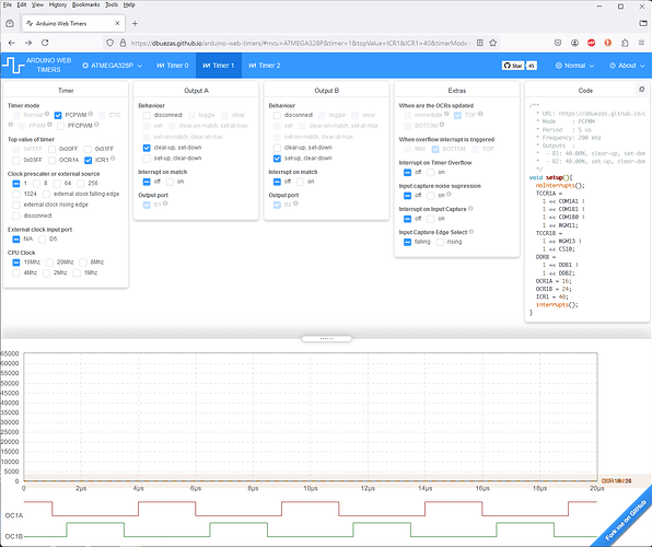

2 pins not just one.
Use a Phase Correct PWM mode.
Set channel A to 40%.
Set channel B to 60% and inverted output.
  * URL: https://dbuezas.github.io/arduino-web-timers/#mcu=ATMEGA328P&timer=1&topValue=ICR1&ICR1=1740&timerMode=PCPWM&CompareOutputModeA=clear-up%2C+set-down&OCR1A=16&CompareOutputModeB=set-up%2C+clear-down&OCR1B=24
  * Mode     : PCPWM
  * Period   : 5 us
  * Frequency: 200 kHz
  * Outputs  :
  *  - B1: 40.00%, clear-up, set-down
  *  - B2: 40.00%, set-up, clear-down
void setup(){
  noInterrupts();
  TCCR1A =
    1 << COM1A1 |
    1 << COM1B1 |
    1 << COM1B0 |
    1 << WGM11;
  TCCR1B =
    1 << WGM13 |
    1 << CS10;
  DDRB =
    1 << DDB1 |
    1 << DDB2;
  OCR1A = 16;
  OCR1B = 24;
  ICR1 = 40;
  interrupts();
The closer you bring OCR1A and OCR1B to 20, the more you get to 50% dutycycle and less deadzone for a H-Bridge driver you will have, assuming that's what you need this for.
e.g.
  OCR1A = 19;
  OCR1B = 21;
would give you a 47.5% dutycycle, but still without overlap.

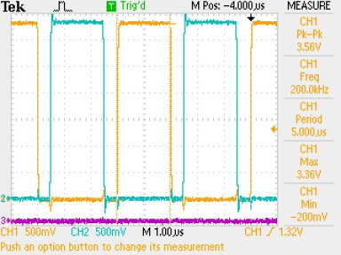

gives
checking pulse width
Thank you so much " [hmeijdam] Edison". It is the best solution. :grinning:
