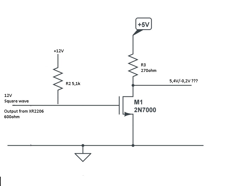

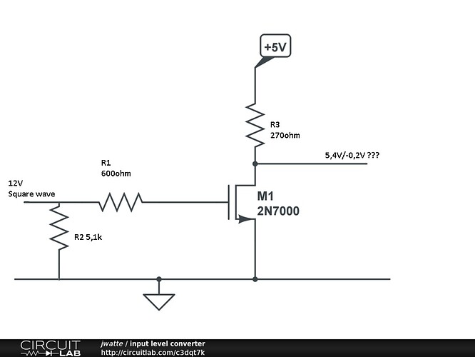

Hi!
I am passing a 12V square wave into a 2n7000 to convert it to a 5V signal (se attached picture).
The problem is that the output voltage level is not 0-5V but instead -0,2V to 5,4V. The error increase with frequency.
With a low frequency it looks ok but with 77Khz I get the above error.
The negative voltage is the worst thing for me because I want to feed the signal to a op-amp to be able to adjust the voltage to 0-10V (with no negative voltage).
The setup is on a breadboard where I have other components using 12V, 5V and -5V (op-amp). All GND is connected on the breadboard.
I have measured the 5V rail and it is exactly 5V. I use a bench power supply for 12V and 5V and a ICL7660 IC to produce -5V.
/Olof
Hi, connect the gnd of the CRO directly to the Source of the FET, connect the input of the CRO directy to the Drain of the FET and see what comes to light.
Check the DC supply voltages with your CRO and compare them with the DMM.
MAKE SURE THE CRO IS IN DC MODE NOT AC.
Tom...... :slight_smile:

Using x10 probe? It needs the trimmer cap adjusting, that's all...

Well make sure you are getting the same amplitude of edge at all timescales...
Hi, can you post a screen shot of the scope trace thanks.
I'd agree that it is not a big problem and your following amp will probably sort things out.

The image I posted was wrong.
The pulldown resistor is actually a pull up resistor. I misread the datasheet, the 600ohm impedance is just for the sine/tri output and not for the square wave output which is open collector.
I noticed something, If I place a 1K pulldown resistor after the pullup resistor I get a output voltage of +80mV to 5V.
Why is that? Should I use a trimpot and adjust the pulldown resistor until I get a nice 0-5V?

[soapbox] Hi, damn digital virtual world CRO's, I would say if I looked at that trace on a good CRO (analog) I would possibly see 0V to 5.0V.
Why because that is what is being produced, look at the digital trace, it is 0V to 5.0V.
Its that damn statistical box that is telling you max and min.
The max may have occurred for a poffteeenth of a milisecond, not for all the top of the waveform.
The min may have occurred for a poffteeenth of a milisecond, not for all the base of the waveform.
[/soapbox]
The stat box says that the trace is 360mV over 5V, thats 1/3 Volt, show me. the top and base lines are thick as .25V for a start.
The max and min that have been "measured" are glitches / overshoots usual when observing non-sinusoidal wave forms.
(Does the act of observing a phenomenon affect the phenmenon, hence distort the observation, big question)
Tom.. hmmm soapbox felt good...... :slight_smile:
