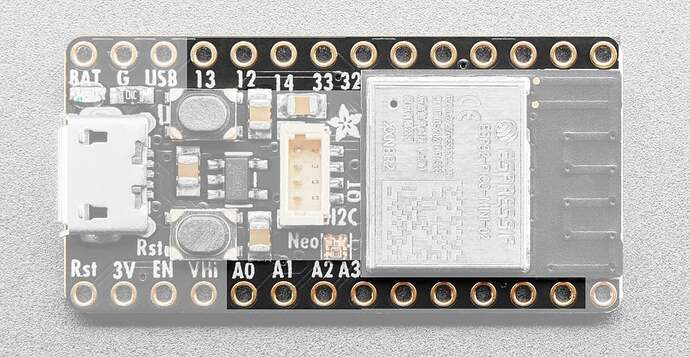

In our project, we are using UART to communicate from an ESP32 Itsy Bitsy microcontroller to a BNO085 IMU, and the getSensorEvent() that is responsible to grab sensor data from the IMU is looping forever. Why is this?
Below is the code. In our serial monitor, we receive the print statements from each println up to Serial.println("Before getSensorEvent") , after which getSensorEvent() runs and we do not receive any more print statements.
