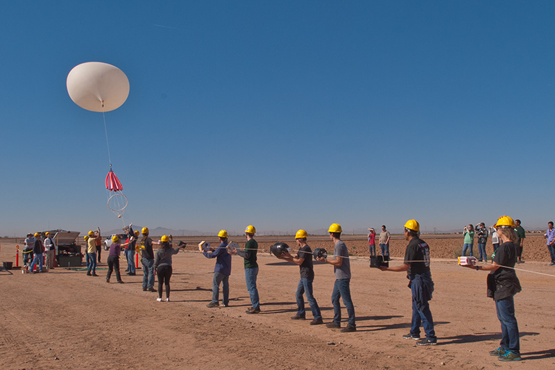

Here are a couple more pictures, the first one is the launch. Each payload team has a representative in the line (ours is the fourth from the right):
Next is a sequence of the recovery. The entire flight is between half an hour and an hour. We've tried a bunch of stuff, and the best seems to be a lora broadcasting gps data and an identifier code. That way we get a location, and drive, 4 wheel, and hike to retrieve it. It takes anywhere from an hour to a day and a half to recover the capsule. Over 8 launches, we have recovered all but one, although one recovery was little more than pieces of what used to be the student's semester long project. But this one was intact, and the gopro kept right on snapping:
