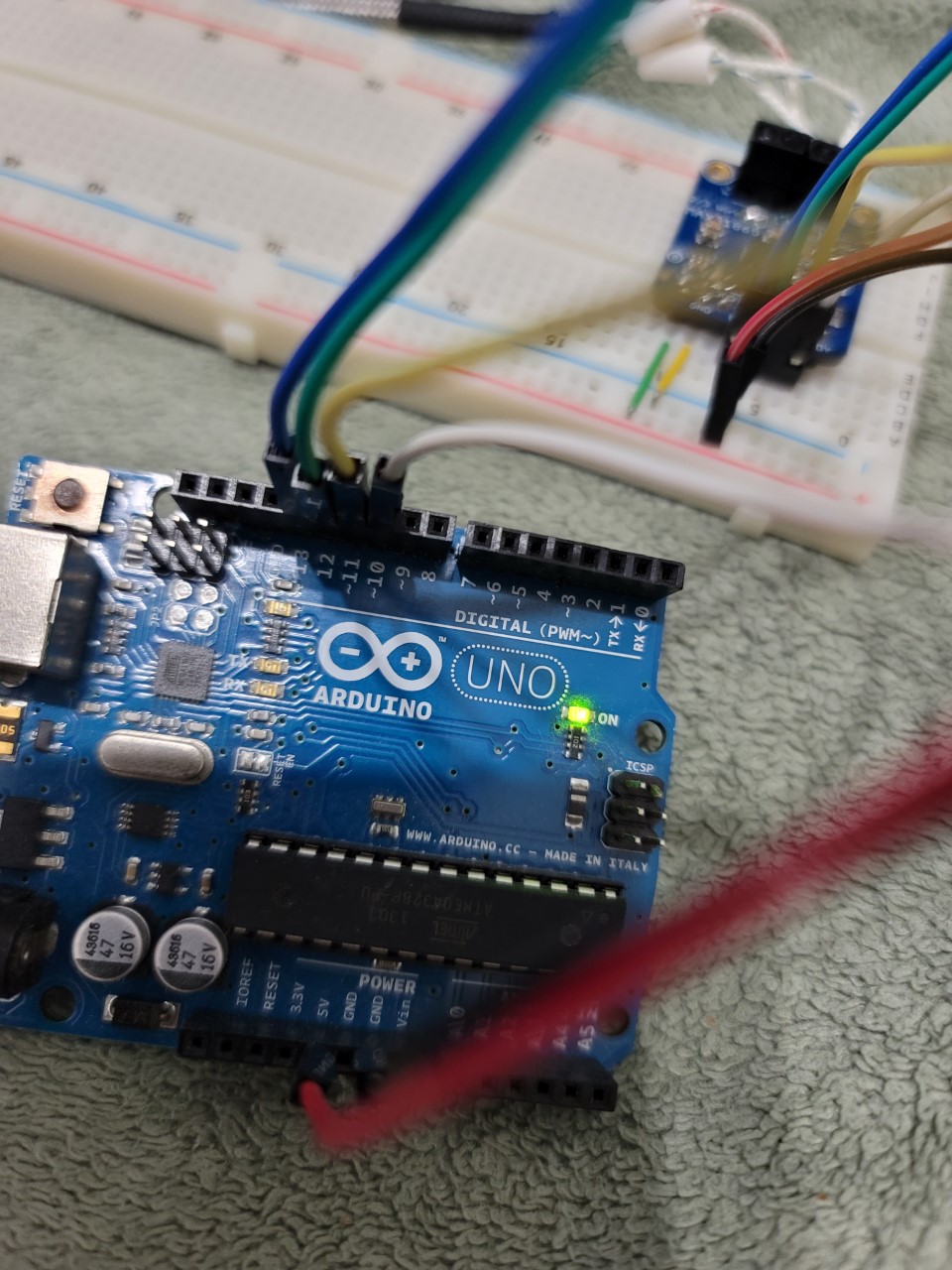

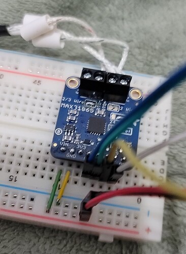

Hello,
I bought these two items
https://www.amazon.com/gp/product/B07DP3LYPX
https://www.amazon.com/Adafruit-PT100-Temperature-Sensor-Amplifier/dp/B01N4LEVZN/
and I am using the stock ada fruit code. I did solder the "2/3 wire" jumper, break the "24 3" trace and also soldered the 3 jumper.
This is the result I am getting back
00:56:46.155 -> Adafruit MAX31865 PT100 Sensor Test!
00:56:46.247 -> RTD value: 832
00:56:46.247 -> Ratio = 0.02539062
00:56:46.247 -> Resistance = 10.91796875
00:56:46.247 -> Temperature = -217.48
00:56:46.340 ->
00:56:47.384 -> RTD value: 831
00:56:47.384 -> Ratio = 0.02536011
00:56:47.384 -> Resistance = 10.90484619
00:56:47.384 -> Temperature = -217.48

The only thing that is weird on this is that my sensor has 2 negatives and 1 positive (while adafruits example has 2positives and 1negative) This shouldnt matter as I understand the PT100 is only a resistor.
Also in the ada fruit example, it appears that they have a cap around (row 11)
Thanks for any help you can give

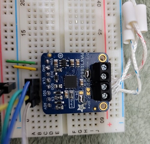

The cap is extra decoupling of the 5volt supply.
Does the board have a 4300 or a 4301 Rref resistor.
I think I can see a blurry '1' there.
Leo..
Thank you for the reply. It has 4301
Hmm. 4301 resistor is for PT-1000. Try to connect a 1K resistor instead of sensor . You should get reading around 0C (32F)
Amazon supplied you with the wrong board.
4301 (4300 ohm) Rref is indeed for a PT1000.
Must be 4300 (430 ohm) for a PT100.
Leo..
Wow you guys are exactly right.
The sealed package from adafruit actually says PT100 RTD. Crazy.
Thanks for the help!
