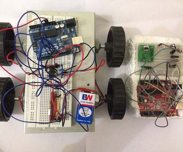

thanx for your answer i succesfully created the program as i am creating gesture based robot using arduino and L293d ic i need some help as you know motor rotates when there is opposite olarity on either end and through porgram i have given several instruction you can check below..
int lm=9;//pin 9 of arduino to pin 7 of ic
int lmr=8;//pin 8 of arduino to pin 2 of ic
int rm=10;//pin 10 of arduino to pin 10 of ic
int rmr=7;//pin 7 of arduino to pin 15 of ic
//+ve of lm to pin 6,-ve to pin 3 //+ve of rm to pin 11,-ve to pin 14

in this case my motor is moving backward in high low high low condition but when i do change to low high low high mototr does not rotate in forward direction ..??
Have you got the rest of the chip wired according to this diagram?
yes i have made connections like this only my robot is moving only in backward direction or left and right but my bot is not moving in forward direction that means when i provide low high to motors it doesnot rotate i hae tried several combinations...
I think the L293d is suitable only to 5khz, you alternate high and low way too fast probably as the write takes only 50 microsecond which is 4 times too fast compared to 5kHz
Try just adding a delay(1); between setting up high and low.That is just for testing.
As you can go to 5kHz you could use delayMicroseconds(200); to be very close to the rated 5kHzwith a bit of protection because the digitalWrite will slow things too you could be ok going to 150 or do instead of 200.
Does the motor work forward and not backward if you reverse the wires?

my project is gesture based robot for that i ineed rf trasmitter and reciever
my transmitter program with adlx335 sensor is

now i have make reciever program for the simultaneous transmitter program below
#include <VirtualWire.h>

digitalWrite(rm,LOW);
digitalWrite(rmr,LOW);
digitalWrite(lm,LOW);
digitalWrite(lmr,HIGH);
digitalWrite(ledPin,HIGH);
//Serial.print("\n");// debugging
//delay(1000);
the problem is that my bot is not moving at all at any gesture my transmitter is working plzz suggest something
