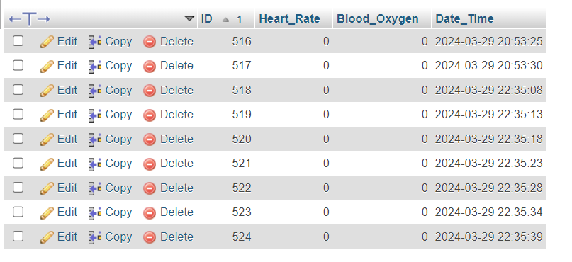

Getting MAX30100 sensor values 0 in the local database
When I written code for post data into the database that time I am getting sensor reading properly on serial monitor but in the database sensor values become 0.
Esp32 code is below*

void postData(float value4, float value5) // This is the main method where data gets pushed to the local server
WiFiClient client; // Creates a client that can connect to to a specified internet IP address and port as defined in client.connect().
HTTPClient http; //HttpClient is a library to make it easier to interact with web servers from Arduino.
http.begin(client, servername); // Your Domain name with URL path or IP address with path
http.addHeader("Content-Type", "application/x-www-form-urlencoded"); // Specify content-type header
String httpRequestData = "api_key=" + apiKeyValue + "&BPM=" + String(value4) + "&SpO2=" + String(value5) + "";
Serial.print("httpRequestData: ");
Serial.println(httpRequestData);
int httpResponseCode = http.POST(httpRequestData); // Send HTTP POST requests
Serial.println(httpResponseCode);

****Serial monitor output
*PHP mysql code
<?php $servername = "localhost"; $username = "root"; $password = ""; $dbname = "iot_test"; $api_key_value = "tPmAT5Ab3j7F9"; $api_key = $value4 = $value5 = ""; if ($_SERVER["REQUEST_METHOD"] == "POST") { $api_key = test_input($_POST["api_key"]); if($api_key == $api_key_value) { $value4 = test_input($_POST["value4"]); $value5 = test_input($_POST["value5"]); // Create connection $conn = new mysqli($servername, $username, $password, $dbname); // Check connection if ($conn->connect_error) { die("Connection failed: " . $conn->connect_error); } $sql = "INSERT INTO test_db (Heart_Rate, Blood_Oxygen) VALUES ('" . $value4 . "', '" . $value5 . "')"; if ($conn->query($sql) === TRUE) { echo "New record created successfully"; } else { echo "Error: " . $sql . "
" . $conn->error; } $conn->close(); } else { echo "Wrong API Key provided."; } } else { echo "No data posted with HTTP POST."; } function test_input($data) { $data = trim($data); $data = stripslashes($data); $data = htmlspecialchars($data); return $data; } ?>
******Database output
