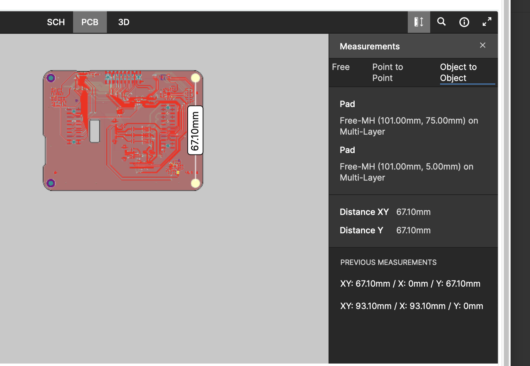

@KurtE where can one find this interactive viewer of which you speak? I looked around briefly and no joy. Is this maybe a feature available if you have an Altium seat using the PCB files?
Click the globe icon here on the GIGA Display Shield documentation page:
Thanks. But, I notice an error in the results. As you can calculate from the XY coordinates of the holes, the measurements I made are correct. But, the reported distance is wrong.
  • 70 mm displays as 67.1 mm
  • 96 mm displays as 93.1 mm
I think what's happening is that the tool is reporting edge-to-edge distance, rather than the more traditional center-to-center distance. If you click on the mounting hole, it shows a 3.2 mm hole with a 2.9 mm pad (!). If you measure the distance from the edges of these imaginary 2.9 mm pads, the distance that the interactive tool reports is correct. But even that isn't a real feature that one could physically measure. You could measure the distance between the edges of the holes, but that isn't what the tool reports.
I've run into this and hence stumbled on this forum post! Arduino, that's so annoying! I filed a report with them and provided them feedback to make it easier on us and provide proper dimensions on their PDF datasheet.
However, it seems the interactive viewer can be used to some advantage. Instead of clicking on the measurement tool, just click on the pad (or hole) of interest and note its X and Y coordinates. 0,0 is the bottom right corner, and the board is 106 x 80, so @the_stumbler got it right by using his trusty ruler and eyeballs! The mounting holes are 5mm each from the edges.
