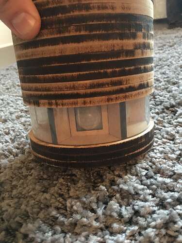

hi all ill clear a few things up and add photos of the project. The 6 PIR sensors are mounted on the stationary base the only bard that will revolve is the top plate this will be used to mount a DSLR or other wireless camera. my sensors all work and give readings using the code attached below the code is based on a project similar to mine but they were working in 180 degrees rather than the 360. I was hoping the mechanical switch between the stationary body and revolving top plate would allow me to map the continuous servos movement for 360 degrees giving it positional awareness in a sense as the stops have been removed. if this is the case then the servo top plate should recalibrate every time is passes and creates the contact and maintain its accuracy. I am aware that the end footage won't be brilliant but as a concept I can build on this later

I understand you have a continuous servo, not a 180deg type, so you can only tell the servo to got one way or the other , but not to a particular direction.
If you have a reference limit switch, to give you a start position, how will you know how far you are turning from that reference position?
Tom.... :slight_smile:
How about sticking a small magnet on that board and then attaching a hall effect sensor or reed contact on the other side. One as "zero reference" or one at each PIR location so you can use this to know when you're pointing in that direction.
I was planning on having this switch contact and then run the continuous servo for the number of microseconds specific to my servo for 6 segments of 60 from the point of contact. The servo from point zero will detect motion at say 180 know that is three 60s from 0 and move there and so on I could be wrong though?
That is known as dead reckoning and is a lot less successful than you might hope. The thing is that every time you start and stop your motor their is an acceleration up to the working speed, and it is hard to account for this. Also changing direction introduces hysteresis in the gears.
