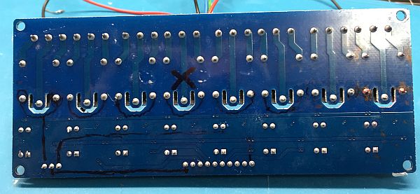

If you flip your board over so that it's oriented as shown in my picture, you can apply voltage to the pairs of pins I have marked (all 8 pairs). If the relays are functional, you'll here them click. You may still be out of business, but you can answer the question-- Do your relays click?
I used a 5v bench power supply with a current limit of 1 amp. The good relays drew about 72mA. The bad ones would peg the 1amp limit and my leads got hot. If you don't have a power supply, you can use some other 5v source. And since you can't control the current (the 1 amp limit I mentioned) you'll know the relay's shorted by the smoke (and no click). No click, no smoke = open-type failure.
But know this: I went through the whole board five or six times, marking the ones that worked and the ones that didn't. On subsequent checks, the bad ones checked good. So, you'll get some false results. I don't know if that speaks to the Chinese quality, or maybe I have some that are on the fence. The one with the black X consistently checks short.

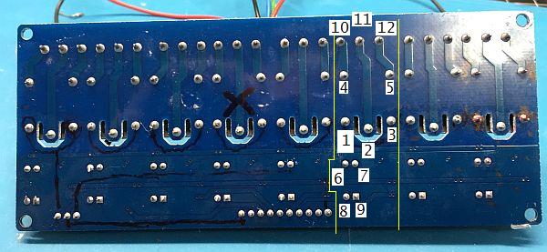

I can't tell by the schematic which solder joints would be the probe points for D2. Apparently, my previous probing was 4 and 5. So I got in diode mode and checked them both ways. The unit with the black X was a dead short. All others were 0.037v in either direction. Uhh.. what's that all about? Thank you
Can you tell me which points would be for checking D2? Thank you. Note: My number tags are just random, no correlation to the numbers on the schematic.

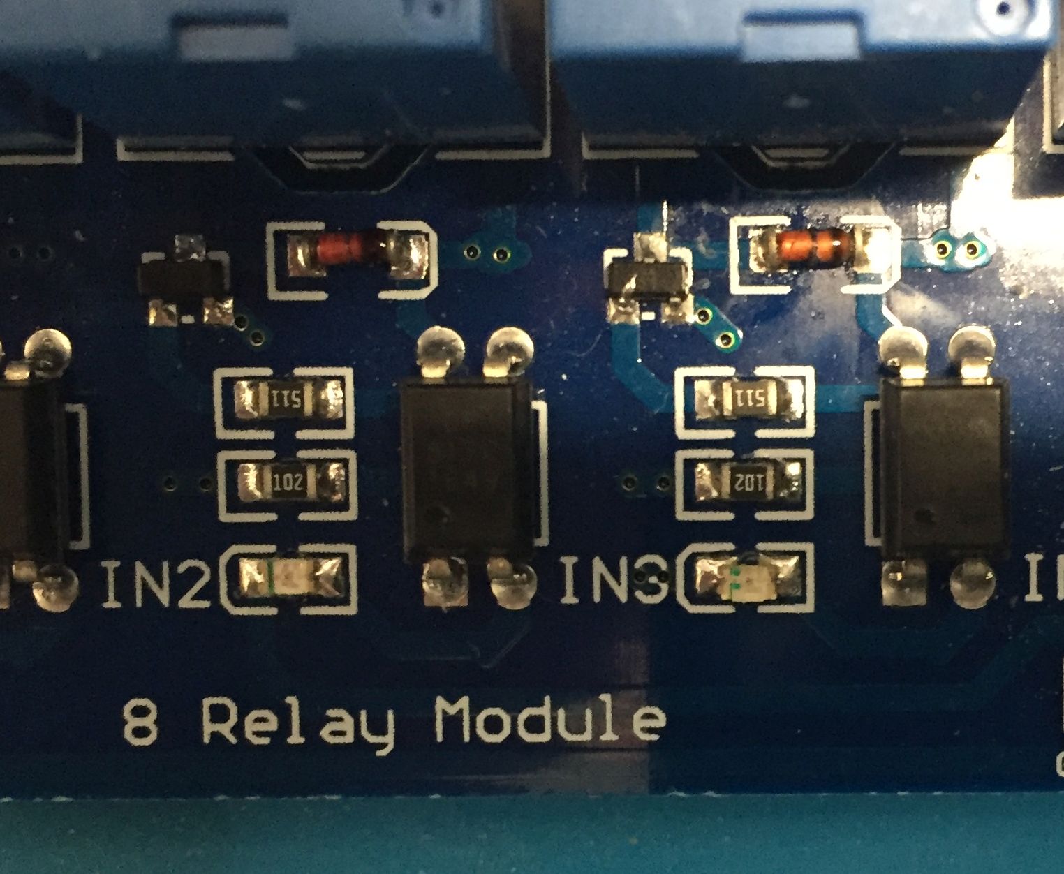

The diode is hidden in this image, it will be a SMD package.
You can easily damage low amperage diodes if you forward bias them with 1 amp.

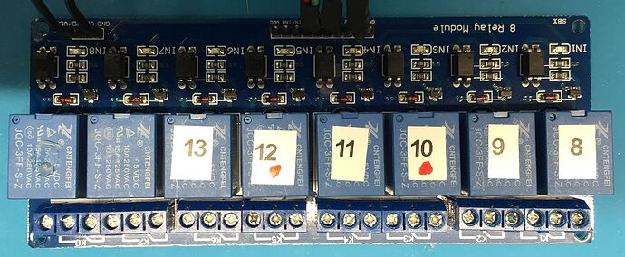

Thanks to a Robert Bacon video, I learned that I was connecting my relays incorrectly. To my great surprise, they work perfectly when following his instructions. Oddly (very oddly), the unit that shows dead short on probing, also works (clicks). But I'm learning a lot from this interchange with you and want to see it through. Maybe this can be a reference thread for others. Adding the Bacon link, photos coming shortly.

The 8 orange components close to the top of each relay is the kickback diodes. i.e. D2 equivalent.
The 3 terminal device to the right of each diode is the relay driver transistor.

Also, the diode and transistor on the left right look suspicious.
