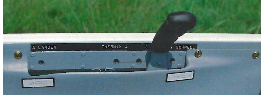

It slides forward /backwards in one direction for a length of around 20 cm, typically over a 20 mm tube or so.
Flap handle ASW20
Ronald
To provide minimal mechanical connection to the flaps lever.
A magnet on the lever and a set of Hall Effect devices at each of the setting points would probably do the job.

The picture of the handle.
Hello
My recommendation:
Do not make any changes to the cables or similar. Simply drill through the holes and install LDR's from behind, however designed.
grafik
An intelligent evaluation of the LDR's enables the OLED view of the current position of the control levers.
