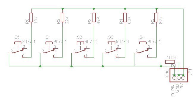

You could simplify the buttons using a resistive ladder to get up to 6 buttons on one analog pin.
The one often used on the LCD shields is usually my GOTO for multiple buttons.
There is a destructable with a code example too HERE that also includes debounce options.
