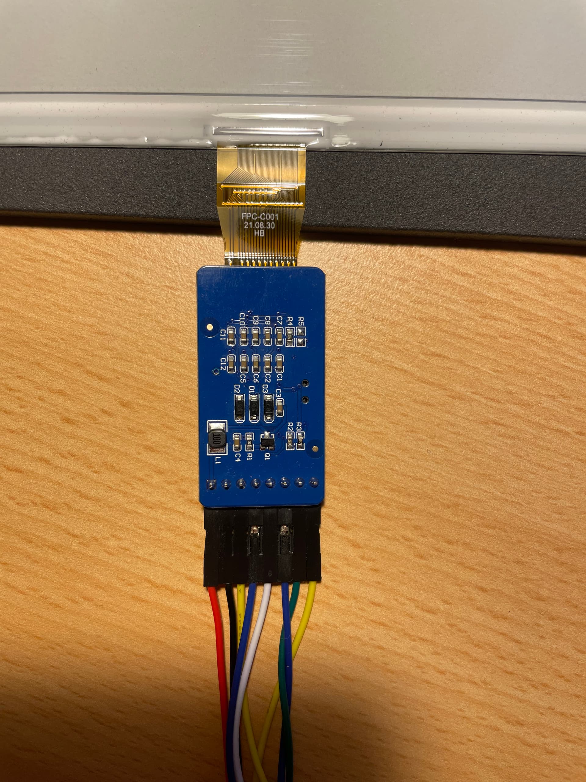

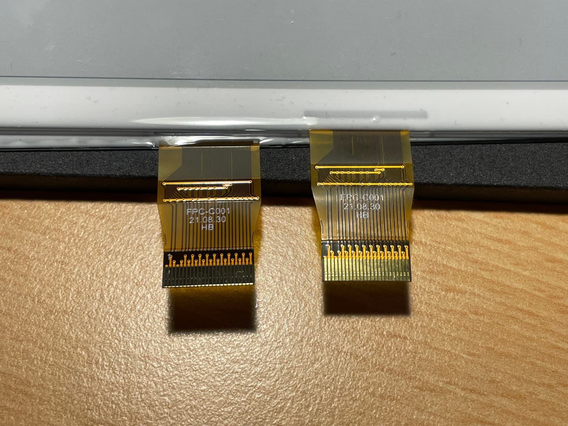

I have bought two e-paper displays with 7.5 inches (four grayscales, not the color). One was from Eckstein the other was a noname display from Aliexpress has no special designation. The one from Eckstein is a GooDisplay GDEY075T7, the one from Aliexpress has no special designation. Both ribbon cables are labeled the same: FPC-C001 21.08.30 HB. So I think it is the same display.

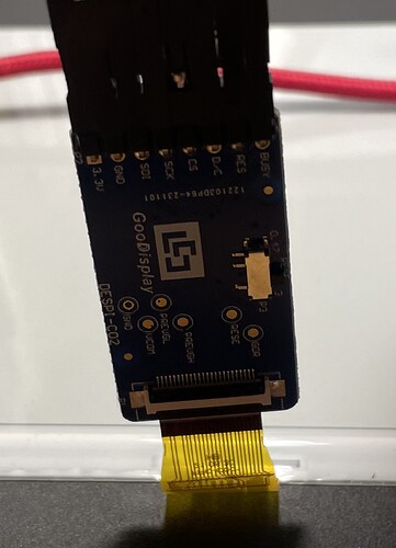

Unfortunately I can't get both to work. I am using the Goodisplay DESPI-C02 board. You have to set a resistor on the board using a switch, the instructions say which switch setting is required for which display. Unfortunately, my display does not appear in the manual, only one with a very similar designation: GDEW075T7. Is that the Promblem? I have tested both.

In the GxEPD2_display_selection_new_style.h file it says FPC-C001 20.08.20 for the GDEY075T7 display, what do the last digits mean, is this the production day, in my case it says 21.08.30. Is that why mine isn't working?

Hi @ottomohl
Your connection of the DESPI-C02 to the display panel is flipped!
Make sure that pin 1 goes to pin 1 of the connector.
Note that the FPC connector has connections on the bottom and the top side.
Good Luck!
