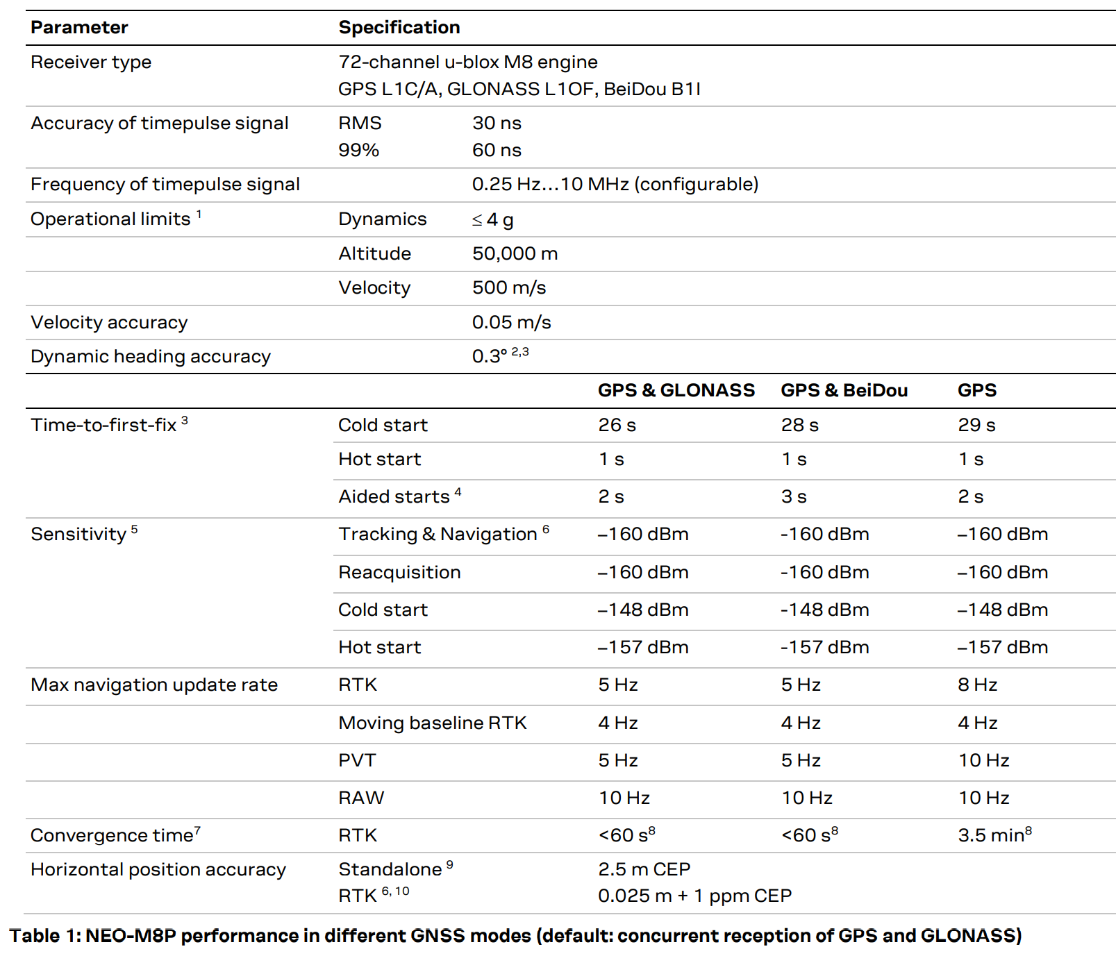

As I read the NEO-M8P datasheet, accuracy (CEP - circular error of probability) is 2.5 Meters. In RTK usage, > 0.025 Meters.

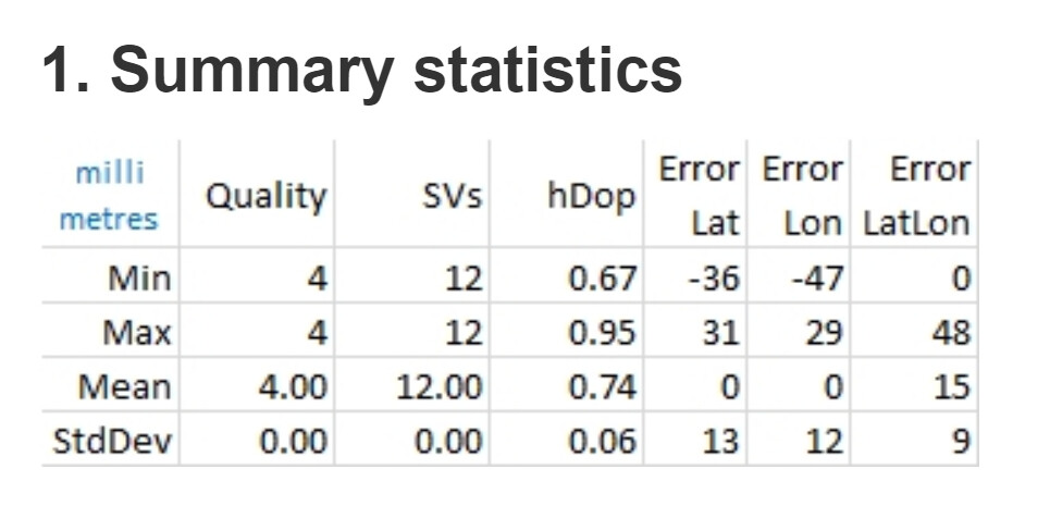

Correct. In the C94-M8P kit, the base station provides either a relative or absolute position (if known), and broadcasts corrections to the rover. Rover positional accuracy is typically +/- 10 cm relative to the base station.
For extensive tests under a variety of conditions and a performance review, see UBlox C94-M8P RTK GPS review and performance evaluation – Maurice's Musings
My own experiments bear out the above results.
