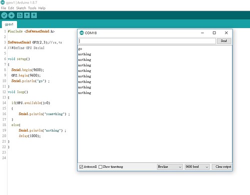

hi,
I'm trying to get time from GPS module.
But the situation is so strange..
I bought neo 6m module few days ago.
It had micro usb port to directly connect to the pc.
To make sure its fine,i plugged it in,open arduino ide serial monitor.
Works great! everything its normal on screen,tons of information($GPRMC,,,,).
Now i'm trying to connect it to my board,and it Shows nothing.
vcc- 5v or 3.3v
gnd-gnd
rx- 2
tx- 3
help...
btw any one know whats PPS pin for and how to use?
Hello Henry.
The GPS board outputs its data on the pin labelled TX. This has to be connected to the pin on the UNO that receives data and that is the RX pin of your software serial port (pin 2).
So, it shud be:
GPS TX -- UNO pin 2 (RX)
Don't be concerned about the GPS RX pin connection until you want to transmit a configuration command from the UNO to the GPS. In other words, you don't need to connect it to anything, but it would go to pin 3 (TX).
The GPS board requires 5v. It won't work with 3.3v. The board has a regulator that supplies 3.3v to the u-blox receiver.
Good luck.
John.
omg im just being stupid :o
haven't used uart before only spi and i2c
thax bro ,loveu
No prob.
The GPS outputs its bunch of sentences once per second (default). So you might not want the delay(1000).
Have you got an external antenna to attach to that screwed connection? Gives better performance than the on-board ceramic antenna.
John.
