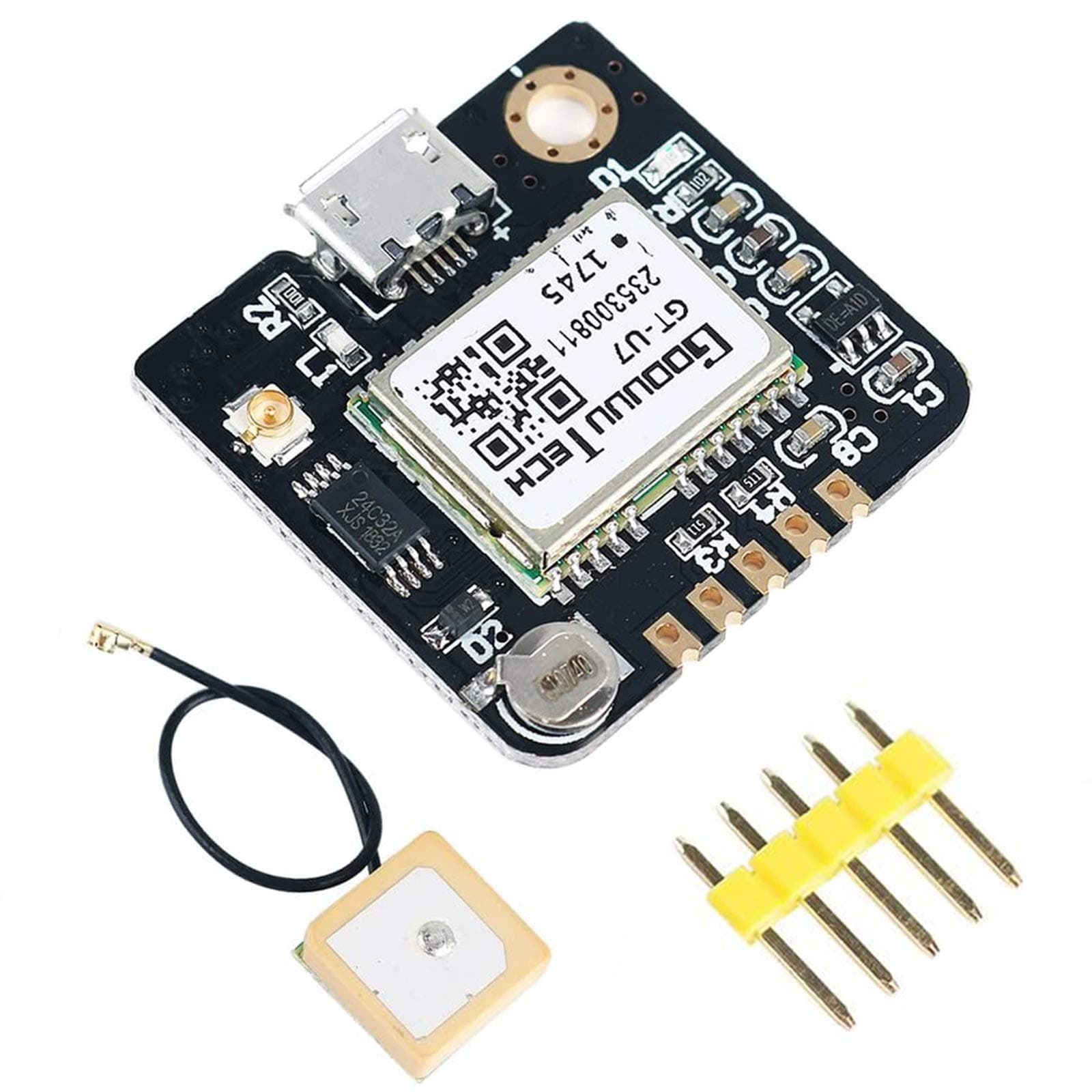

I've been trying to connect my GPS module to my nano IOT for some time now but am not sure how because the Software Serial library does not exist. I don't know what code to use if I use TX RX connection.
This is is the gps module im using:

Note that as its name suggests, the Nano 33 IOT operates at 3.3V rather than 5V. It may not, therefore, be compatible with the GPS. Do you have the specification for the GPS ?
Do you have any sample code I could use? As for the GPS, we can try and send only 3.3 V to it and that will likely fix this 5V issue?

I have that same module. My memory is that it requires 5V power, which is then reduced to 3.3V by the LDO on the module (the little 5-pin chip). So its Tx output is 3.3V. That works well enough with a 5V Arduino. But I've never needed to connect the Rx line. It would be expecting 3.3V input, but the 5V Arduino would be sending data at 5V. So that might be a translation problem if you need to send stuff to the module.
But on the Nano 33 IOT, I think USB 5V connects to the Vin pin through a schottky diode, so Vin should provide 4.7V power, which you can use to power the GPS module. And then data is 3.3V both ways.
But if all you have is 3.3V power, one solution might be to short the LDO's input to its output. That would effectively bypass the LDO, so the incoming 3.3V would go directly to the rest of the circuit. It appears to be this LDO:
If the GPS module requires 5V power and you want to get the power from the 5V pin on the Nano 33 then you need to short the two solder pads on the bottom of the board adjacent to that pin. Doing this connects the 5V from USB to the 5V pin
Thank you everyone for your help! We figured out how to get the GPS working because we only supplied 3V to the breadboard for the GPS. It shouldnt send 5V signals
